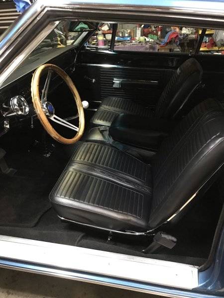

Hey guys , anyone ever had problem with the horn blowing at different spots as the steering wheel turns on 67 Gtx ! Thanks in advance!

The car has an aftermarket, walnut stainless spoke wheel on it , with the Grant adapter, the adapter has a disc used to make contact with the oem roller contact , the adapter had been over tightened, along with the wheel, which caused to much contact with disc and the roller, causing the ultra thin copper surface to be damaged, in random areas, so as the steering wheel was turned, it would find ground and honk ! Another adapter kit , was purchased and installed, to correct the issue! And now the cruiser is back on the road ! 67 Gtx !

My wheel arrived several years ago as I was building the car , looked, pretty good , but I knew it could be better , so I taped the stainless up quite well and polished it with 0000 steel wool, multiple times, until it was very nice! Ordered some McCloskey marine varnish in rattle can ! Sprayed five times and wooled each time up till the last ! Finish turned out like a Diamond! This product is said to be used on high end yachts!
