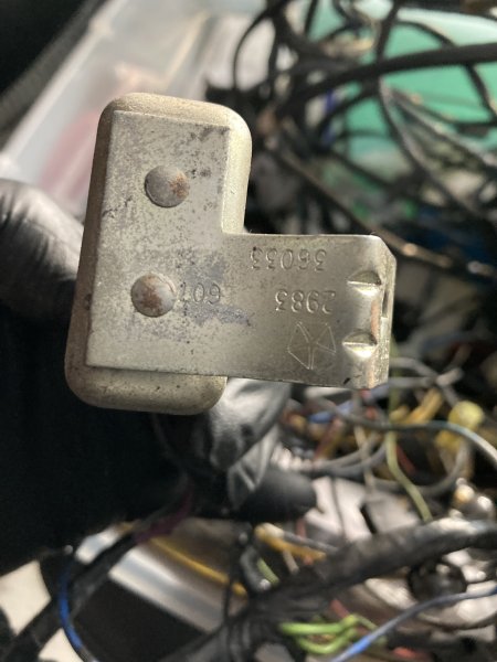

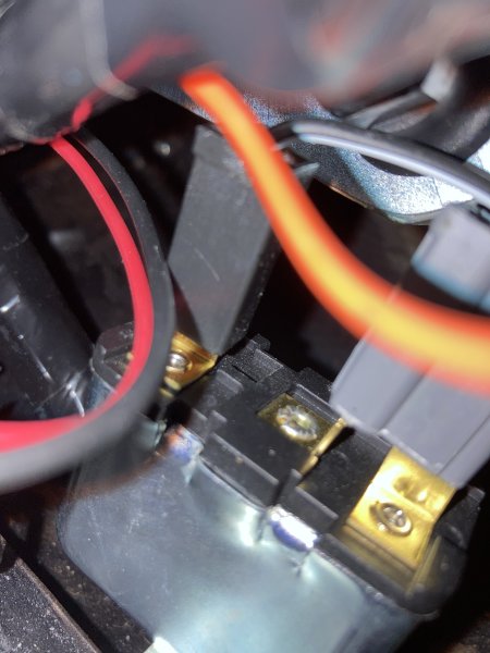

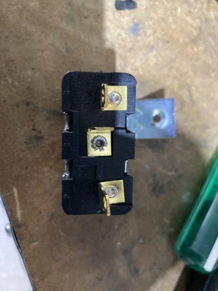

Ok, so I took out the new relay that I got when I replaced the harness. I then put back in the original relay that looks to be the one that came with the car and no beep when hood closes. Amazing! Really disappointing that for 40 bucks I get junk and a 50 year old part works. First two pics are the newer one and last two are oem. You can see that the terminals in the new one are farther apart than oem.
