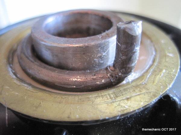

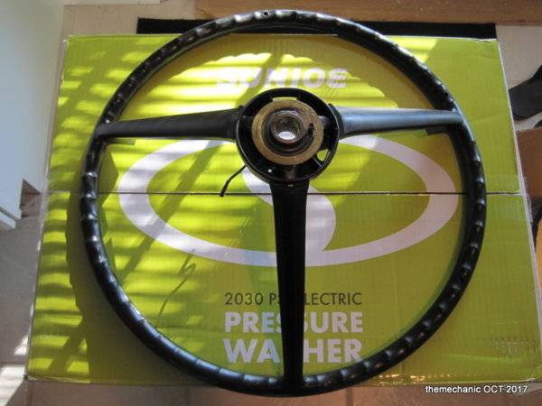

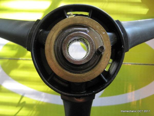

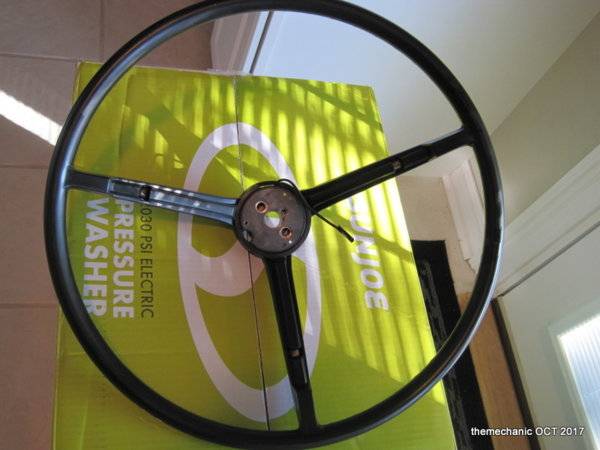

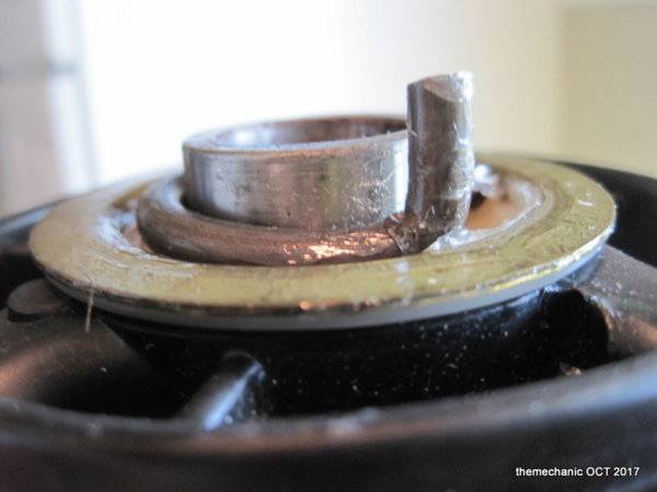

Here's the wheel I took off.
The base on the column side of the wheel appears in the pic to be not square? If that's the case that's the clicking and fitment problem...
I would call who you got it from and get it replaced.....it was made that way and nothing you did....

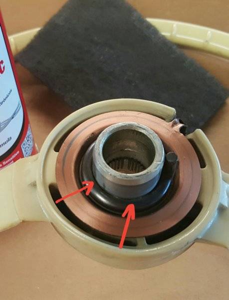

I never had one apart but it looks like the ring is pressed onto the hub and that holds the contact ring tight and flat. Maybe you could try useing something to tap the ring down. It might not be seated where it belongs. (Red arrows) This might have happened useing too long of a bolt in the steering wheel puller? Here's my '62.
