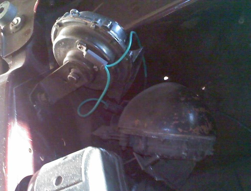

I have my origional horns (high & low) along with the mounting brackets but I took them off many many many years ago.
I ordered a replacement set of horns but I cannot remember the location and position they should be in.
Can anyone take a picture of thier stock horns for me so I can see how they should be mounted on a 67 B-Body. I'm guessing a 66 would also be the same. I need a clear shot of the mounting location. Also is the high horn on the top or is the low horn?
Thanks
Steve
Here is the shop service manual... for 1966... and as requested here is your photo... If you don't mind please take a look at one of my other threads, as you may have the answer for me since you have a 67 Belv.

looks like one horn is correct, (the top one), and looks like the bottom horn is wrong for your 67...it looks too big
Thanks for the pic.
The top one is easy to see, the bottom one is odd looking.

Well I got my horn situation resolved.
The upper horn is the high horn and the opening points down.
The lower horn is the low horn and the opening points towards the front of the radiator support with a slight tilt down.
The installation of the new horns went very well but I did have to relocate my electric fan controller about 3 or 4 inches so the horns are in thier origional location.
Wiring was pretty easy since I already have a relay mounted to power the horns from the battery instead of from the wiring harness.
