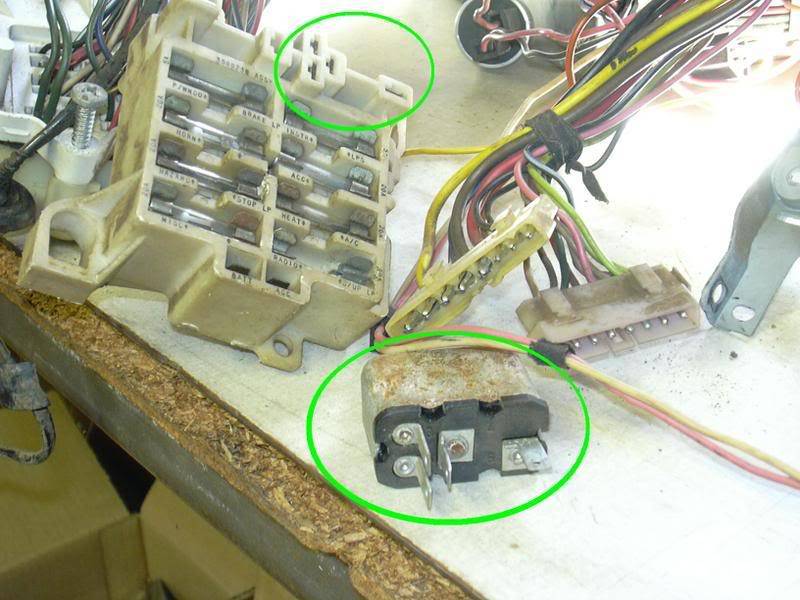

I'm missing the horn relay in my 73 satellite and was wondering if anyone had any recommendations on where is best to get one? Tried roseville moparts but the shipping was going to be more than the relay itself (im based in the uk) and $90 seemed a bit much. Just struggling to find somewhere else that stocks them and rockauto doesnt seem to have the right one. Thank you :)

71/73 horn relay gets the key in buzzer feature built into the relay. Did Fords too?
Ah were those under the dash? I'm on the old style ones then.
Yeah, plugged to the fuse box
Just in case for the OP. All 71/73 bodies uses the same. The only difference could be the attaching bracket when they have it. You could get an A body one (for example) and plug it in there the same just that will have a bracket where B/E bodies don’t. If you want for correctness, can remove the relay itself and switch the cases.
