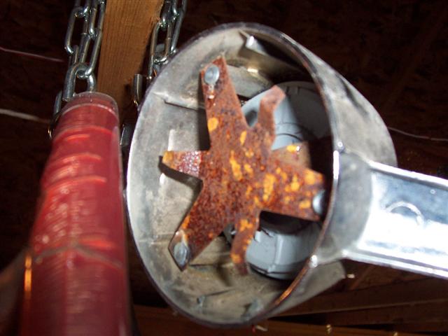

dont push too hard or the horn ring will bottom out on the steering wheel, it should come off easily with a turn, here is what the back looks like.

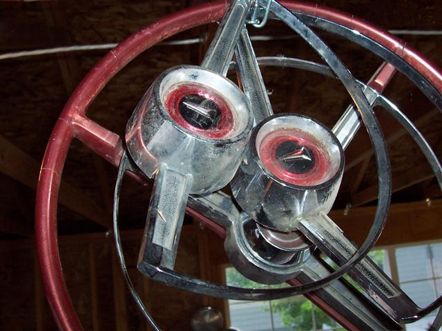

And the front!
