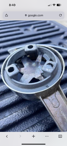

It’s the same - a 65 Plymouth. I didn’t have mine removed the other day so I found an image online.

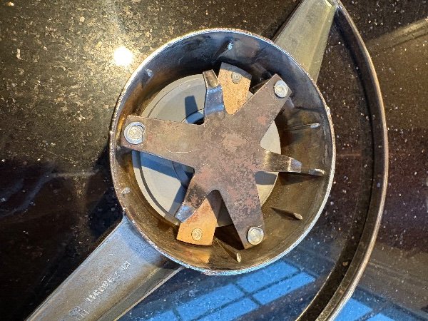

But I just removed it - photo attached
Better description: the play in the chrome ring is both rotational and in the direction of honking the horn. It’s been this way since I drove it in the mid 80’s. Rotationally, I can move it ~1/4” (measured at the outermost point of the chrome ring). In the ‘honking’ direction, the bottom of the chrome ring has 1/8” play. The parts in the column (horn button, attachment screws and plastic spacers) are in good shape and tight. Maybe I’m expecting too much but I’m trying to be rattle-free!
