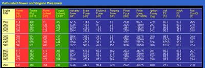

the attachment show`s the area I`d like to be these numbers were done with 10.5 compression, and a high flow duel plain intake.
Oh, I'm running a TREMEC TKO 600 with a .64 over drive. giving me a final drive ratio of 2.62, meaning 80 mph = 2300 rpm so the power band is important.

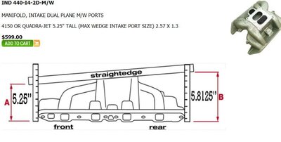

I've checked with INDY there Duel plane doesn't come with the max wedge port it can be opened up (ported) to the max wedge intake size. According to the measurements I will only have 1/2 inch clearance between the air cleaner top and the Carb air horn with a 5 1/2 inch tall intake. I have a CH4B i was thinking about porting to get the most flow i could.

Maybe it's an older intake, but I purchased an Indy Dual Plane Max Wedge intake from
a FBBO member here about six months ago. They're listed on Hughes web site.
I've checked with INDY there Duel plane doesn't come with the max wedge port it can be opened up (ported) to the max wedge intake size. According to the measurements I will only have 1/2 inch clearance between the air cleaner top and the Carb air horn with a 5 1/5 inch tall intake. I have a CH4B i was thinking about porting to get the most flow i could.
I keep going back to that intake it really looks like what Id use. Ill check on Hughes site maybe a can mill 1/4 off the top and get clearance.
Thank you, Hughes is making them. I want to use the full max wedge port if possible. it will be close time to see if I can find room
