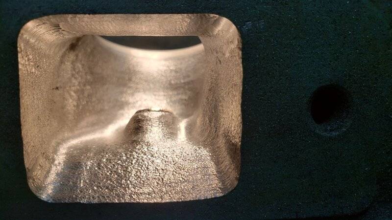

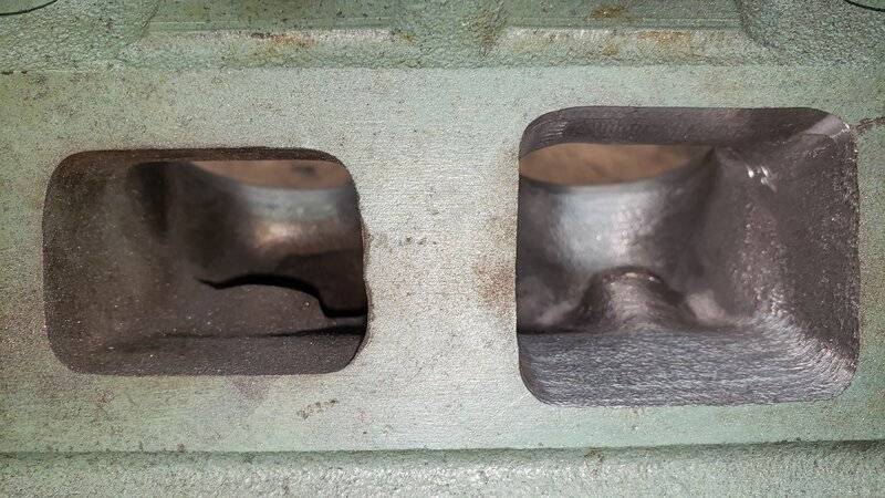

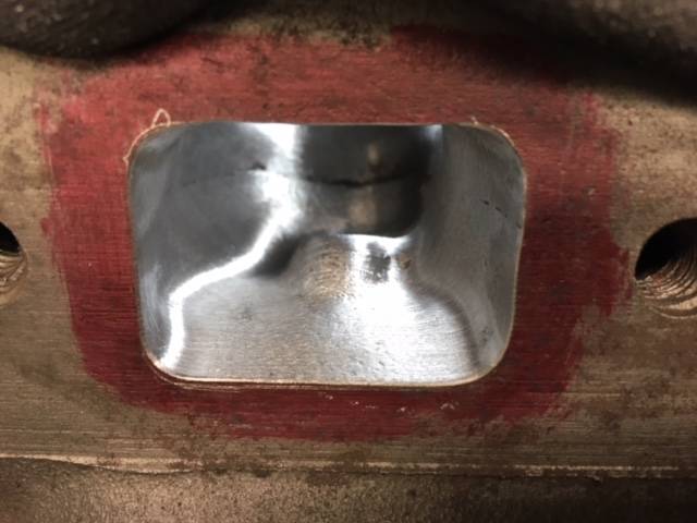

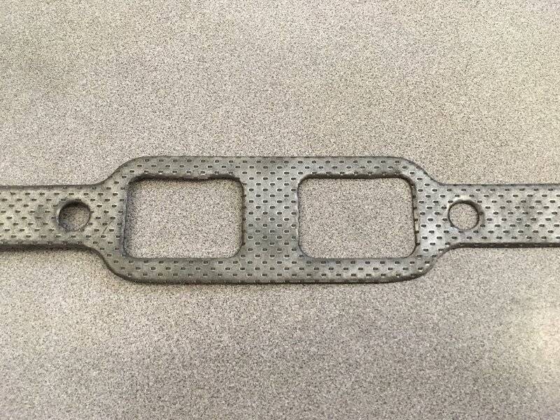

My 906 Exhaust ports after "Gasket matching".
looks good, by chance do you have an idea what they flowed?My 906 Exhaust ports after "Gasket matching".View attachment 1143098 View attachment 1143099
I'm not trying to squeeze out every single HPDon't know, don't care! Just going by what the old timers taught me. After the power stroke,
anything yo do to evacuate the chamber helps. I'm not trying to squeeze out every single HP
out of the engine, just trying to make it more efficient without spending BooKoo Bucks. The
secret to making an engine make HP is how efficient it takes air in, or "Flows". After the plug
fires, the important part is over. Mine is a street engine, so the headers and exhaust system
will give it enough back pressure to do all the Magic.
This exhaust port IS opened up to the stock gasket size!

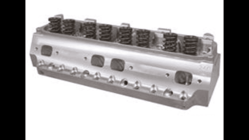

Agreed,

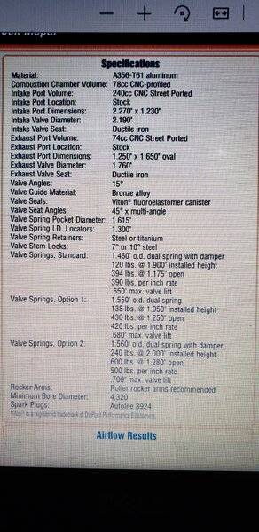

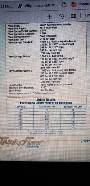

As you know efficiency is measured in CFM, my point CFM needed to meet my goal concerning my under hood clearance!

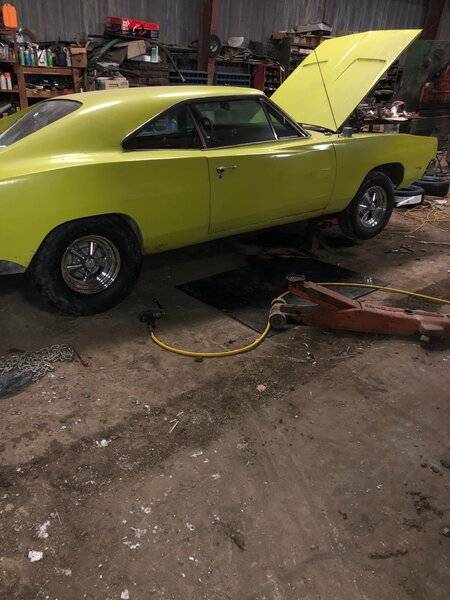

Very possible, however I've found in my years of building cars most (not saying you) state a lot of HP numbers but never really do the DYNO work. You and PRHEADS along with a few other have posted info that makes since. To be honest I'm looking to build my first MOPAR engine in 40 years. the last Mopar was back i the early 80`s. Im doing this for two reasons first I was fortunate enough to pick up 3 cars. and second I'm tired of the same old GM thing. That being said I'm looking to drive the GTX WITHOUT having to reinvent the wheel or monkey with a bunch of know issues.Honestly, you're focusing on the wrong weak links (exhaust head flow and hood clearance) for a 525 build.
This build is north of 500 hp in a 67.
