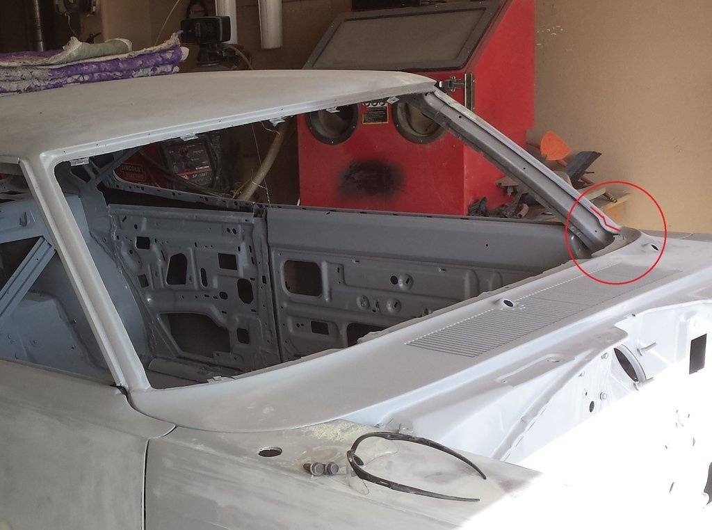

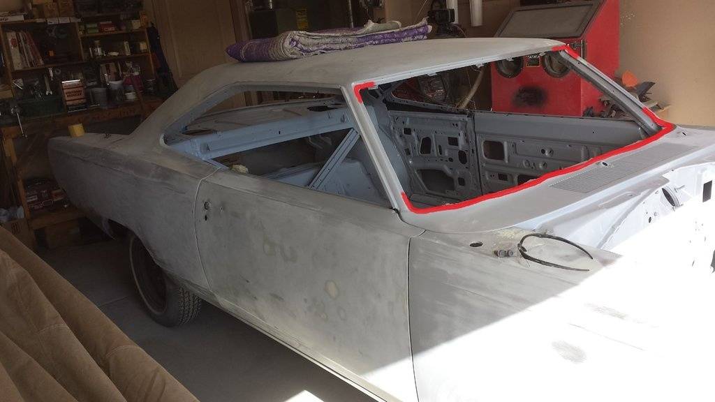

Biggest issue I can contemplate is the sealant used and where it is placed on the windshield frame. The entire lower portion of the windshield weatherstripping just sits on the frame whereas the sides and top are pushed into the weld seam. So the entire bottom and sides up 4" need to be sealed. Same for the top corners.

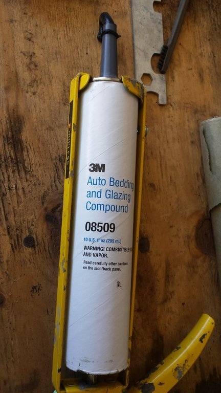

I have heard to never use urethane because it doesn't allow the unibody to flex. However, people have had success using it. The preferred sealer is 3M 08509 Bedding and Glazing Compound.
In red is where the sealant needs to be put...

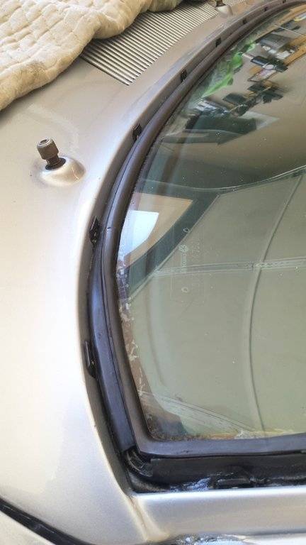

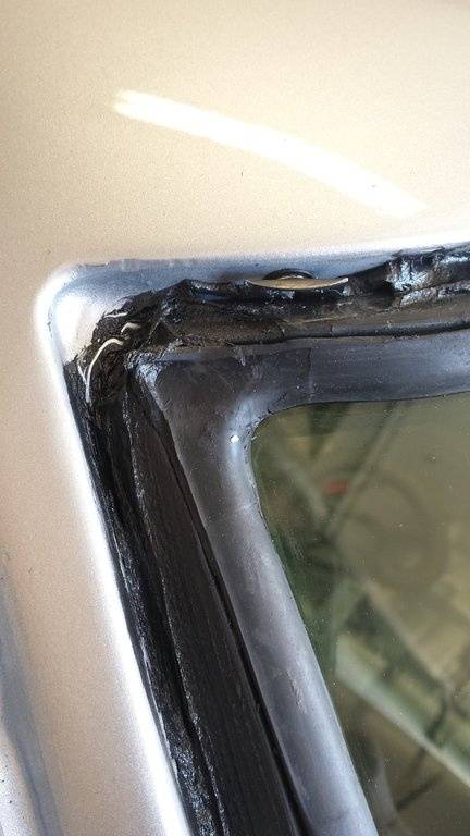

Close up of the transition of the gasket from "sitting on" to "tucked onto" the pinch weld seal. Sealer goes up past this a few inches...

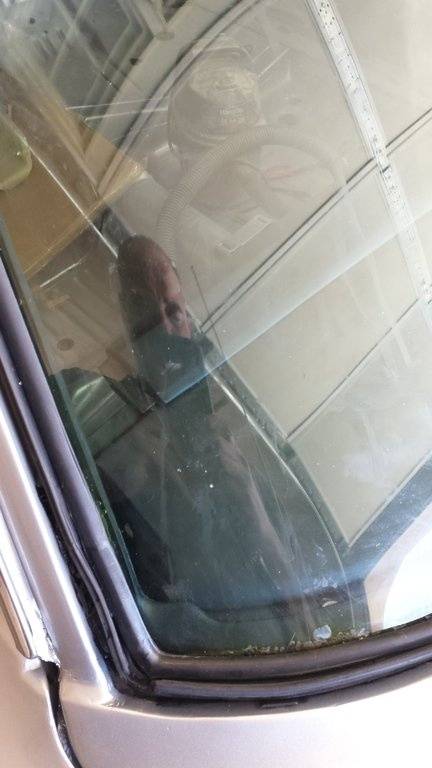

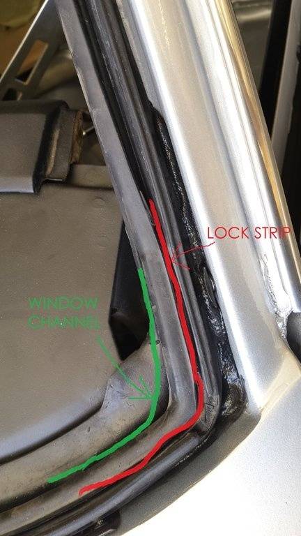

The gasket gets put on the car first. This pic shows the bead lock (very easy to tuck in after the windshield is in place. Notice the sealant before cleaning up...

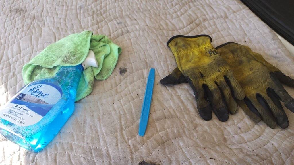

Tools...
Use a lot of windex...it helps lubricate the rubber and glass so it slides easier. Place the bottom of the windshield into the gasket and tuck both bottom corners into the gasket. From here, move on to one of the top corners. These are a B!@#$ and need to be worked in with the plasctic tool. Don't expect it to slide right in and don't start cussing the manufacturer for an out of spec gasket lol. You will need to work side to side, back and forth. Use the plastic bone to open the window channel while pressing the windshield into it. All the time working the tool, sliding and pressing. No pictures of this as I was busy sweating and cussing!

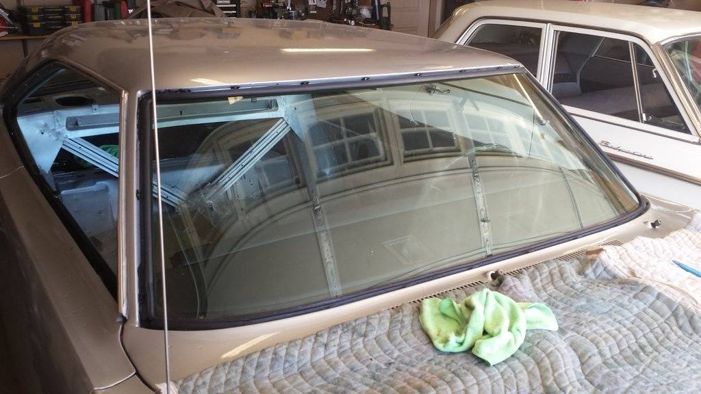

Glass in! Bead not locked.
Glass in, bead locked. Put some more sealant in the open pockets at the end of the bead lock channels...
Tools...
