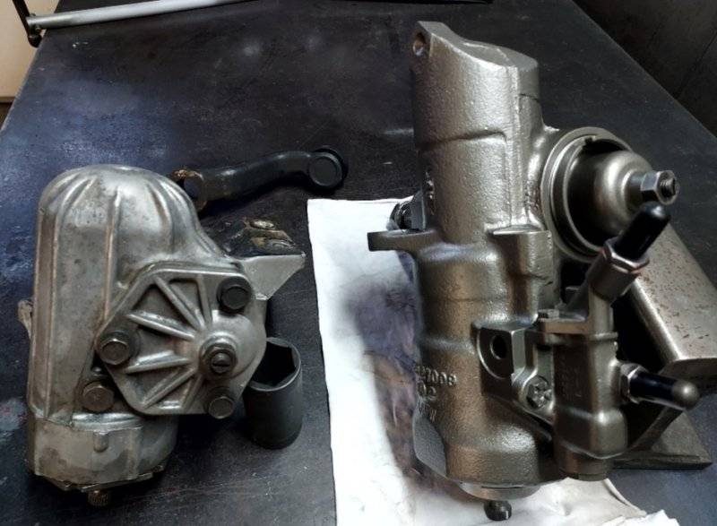

The self centering is influenced by the steering box by some degree. I'll add though that a tire that is really wide will induce more of the self centering since you can see that large amounts of caster will cause the wheel to take on a bit more negative camber at full left and right. This tilts the tire on it's edge which takes effort to do. That effort means resistance that you as a driver has to overcome with additional steering effort. In other words, wider tires may result in better self centering response.
My lowered '69 Dart with manual steering, and as much caster with stock parts as possible, you can really feel the jacking effect on self centering. You can see the front of the car lift, and feel it in the steering wheel. The steering wheel would snap back to center so fast it was a blur. Steering axis inclination plays a part, too. They both influence the scrub radius. All I know is my cars always return to center better, and track straighter, when I give them more caster. Now where do people come up with how much caster a car should have? With power steering, steering effort is never a problem, so why not more is always better unless you get to a point where the tires start leaning too much into the turns, which I have never seen.
