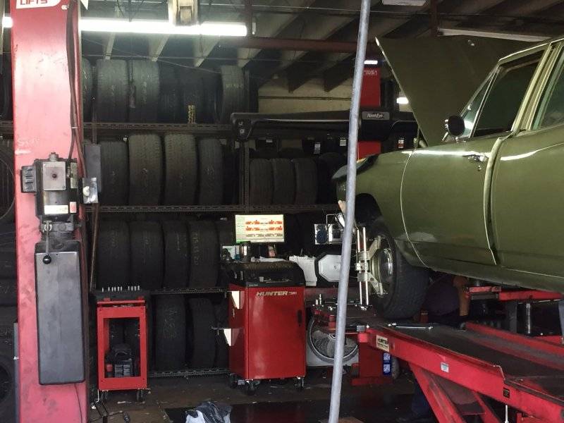

Important: The caster-corrected UCAs were supposed to give me all the caster in the world. And it did: The damn thing now had, according to the shop, 6 degrees of caster, -1.5 of camber, and 0.11 degrees of toe. And it still didn't self-center or track straight, drove like crap, and the left wheel had enough camber in it to be a Honda Civic.
So, two days ago - after finishing a million other problems on the car and at least three years since the last trip to the shop - I finally - finally - went ahead and did a home brew alignment on it. Found a spot of the broken driveway where the car sat within a degree of being dead level, and went to town.
I figured I couldn't eff it up any worse than the shop.

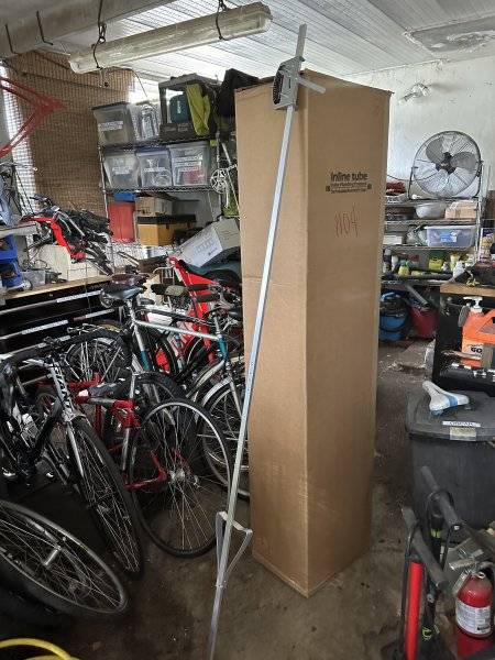

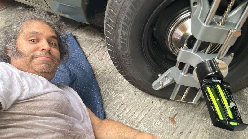

I used a Joe's bubble gauge, one of those fancy clamps that fastens to the rim (because I don't want to be limited to the alignment bubble attached to a hub - I believe the Joes bubble gauge can't do so in the first place, unlike the Longacre models), and for toe, I used el-cheapo plates that rest on the side of the wheel (with modifications so they'd touch the rim and not the bulging tire) and one of those stick-style gauges, and also tested an old Align-A-Matic.

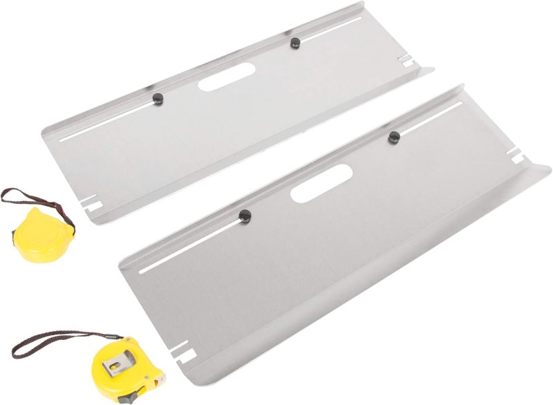

The plates - can post pics of the modifications later
The "stick-style" toe gauge, el Chinesium edition

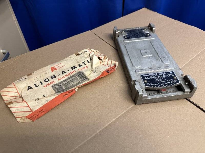

The Align-A-Matic. This is the eBay picture. You can guess how well it worked.
I found about EIGHT degrees of positive caster on both sides, -2 degrees of camber on the left, -1.5 neg on the right, and enough toe in for a flock of pigeons. The car was riding an inch lower on one side because of the excess camber pulling the suspension down, even though the bolt heads on the LCA's were dead level at 1-1/16" out, each.
I farted with it for a couple of hours yesterday, and I'm pretty confident I got to +7 degrees caster after aiming for -0.5 camber and winding up closer to -0.75. I also found that the right tie rod adjuster was almost entirely wound in, but not the other side - and just by eyeballing the car and the steering wheel set straight, I wound up with roughly 1/16" toe in and just about equal threads on both sides - as one might expect. I was equally surprised to find that the plates worked very well, as did the cheap-looking stick-and-gauge tool, but the Align-A-Matic was completely off (eBay time - LOL).
And so I took it for a drive. I figured that now I confirmed how much caster I have, it couldn't be too bad.
Well, going right back to @Kern Dog's Most Important Words of Wisdom Ever:
If you’re stating that the steering feels like the tires are hanging in the air and not connected to the road, sorry to inform you….
That is how many of these cars were when new.
And now I know this for sure.
Point 1: It tracked straight and felt 10 times better, if compared with how it felt before. Moral of this story, #1: Do your own effing alignments.
Point 2: It feels EXACTLY as Kern Dog says - as if the front end is being yanked off the ground at 120mph and getting light.
Point 3: It also somewhat self-centers now, but still needs a bit of a yank during the last quarter of the turn. And now I know that's how these damn things feel even with seven freaking degrees of caster in them, even if the box is self centering correctly.
So I both succeeded (#1) and found out that what I'm after will never happen with a stock steering box (#2 and #3).

Exhibit A: How to waste your money
Exhibit B: "Would you buy a used Mopar from this man? Your answer, should you be sane, is 'no.'"

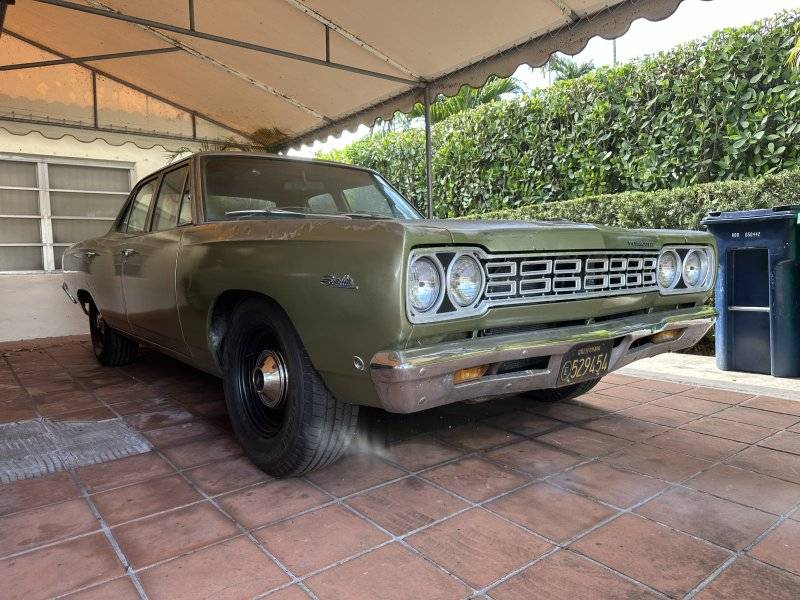

I'd add more to this, but I don't really have anything else to say...so here's a photo of the '68 Satty, because :xscuseless:
