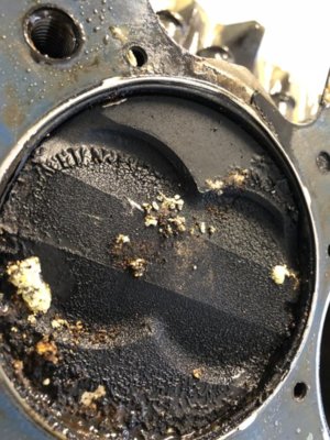

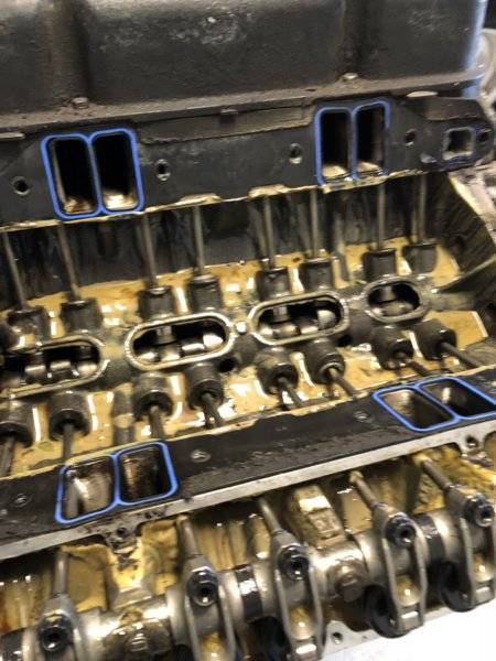

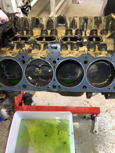

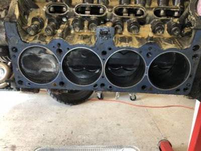

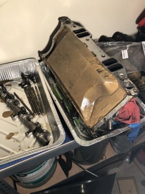

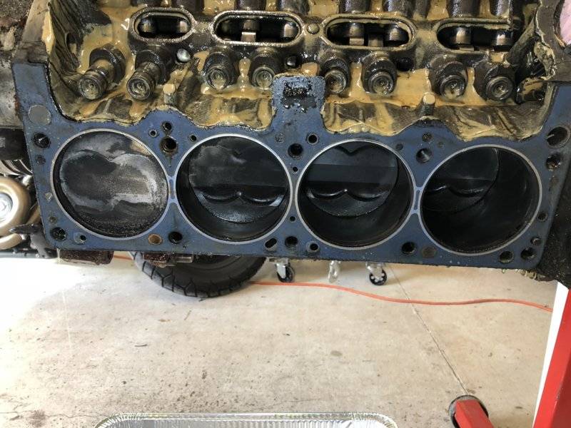

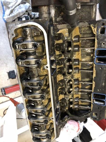

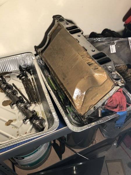

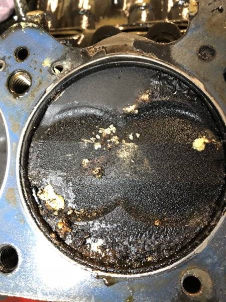

So my engine is covered in yuck...now what.
I haven’t taken off the oil pan yet but I’m guessing it’s more of the same. Can I just spray it down with mineral spirits and then spray atf on stuff or what am I to do??? I really don’t want to remove the whole rotating assembly if I can prevent it..

Complete tear down.
Now or later.
Your choice.
That snot is in every nook and cranny and oil passage and bearing and...well ...you get it....sorry.
I’d tear it all down...... every thing in there needs a thorough cleaning and lubing.
For some reason, I thought it was a big block.

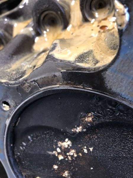

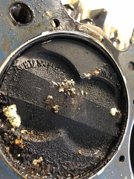

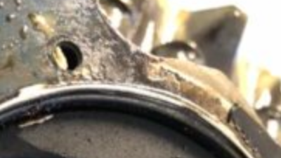

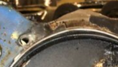

I’d say that missing chunk of head gasket connected to that coolant hole is the source of the problem.
Have you identified the cause of the problem?

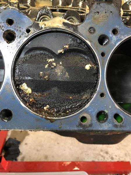

It’s hard to say at the moment the only gasket breach I found was here in this pic around the top of the cylinder. I still need to take off the timing chain cover and see what that looks like. Other than that the head gaskets looked good on all the coolant passages.

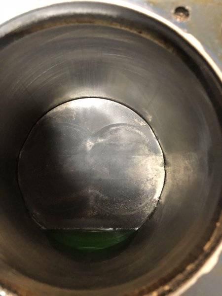

Looks like coolant got into the oil pan, then it was ran awhile. Any overheating issues? How long has it been running bad? Take it all apart, and start again. Was it re built recently?
Pr Heads is probably right the headgasket.
And as the others who have posted said that water is everywhere inside that engine.
Very hard to get out without stripping it down.
This motor was rebuilt about 10 yrs ago, and yes there was coolant in the pan when drained. It was run for awhile before it was discovered unfortunately.
What I can’t figure is why that upper chunk would allow any coolant through because it’s not even connected to a passage

Anything noticeable on the intake gaskets? Near the water passages, could have been dumping into the valley. But that wouldn't explain the coolant in the cylinders.

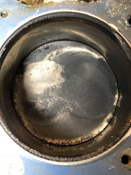

Might I ask why the forward 2 pistons look like flat top pistons while the other 2 have valve reliefs?

Being that it was rebuilt and not ran much, you could probably get away with a light hone if the cylinders are in nice shape or maybe just clean them up with no hone at all. The bearings, those I would replace because antifreeze is very corrosive to them and for the few hundred bucks, it is cheap insurance. I'd have the block hot tanked and see what it looks like corrosion wise and go from there. Id check the flatness and surface finish on that deck surface and the heads and make sure it's flat and wasn't leaking there because of that. Also was the block magnufluxed for cracks? That's ALOT of coolant inside that engine for a small leak unless it was run for some time like you said. $750-$1000 in gaskets and small parts is cheap insurance for the long run if you want it to stay together and provide years or service.
