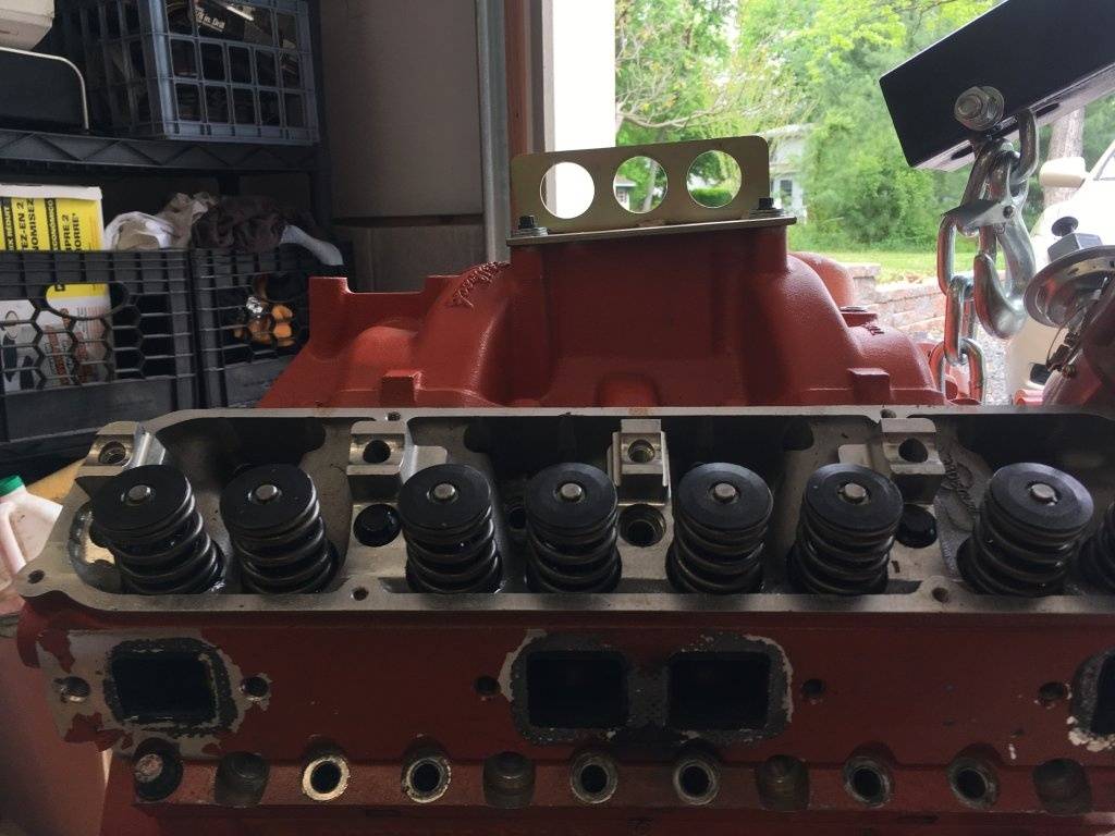

Here's a shot of my 451 and performer rpm intake. Notice that the intake accounts for the front/back engine rake to level the carb out.
HT 413, thanks for the picture! I had to use the visual aide too,I leveled the body out using original Mopar drawings for the reference, blocking up to get the same distance from ground. Then I leveled the intake/ carb while on the engine in the body / hooked to front mounts to get that correct. Back under the car, I built a cardboard template of bottom of NEW tranny mount bushing to where the support structure will mount to frame. Now all I have to do is wait for the metal-shop fairy to turn cardboard into steel and I'm done! Maybe I should leave a couple beers in a cooler at night to help this along......
