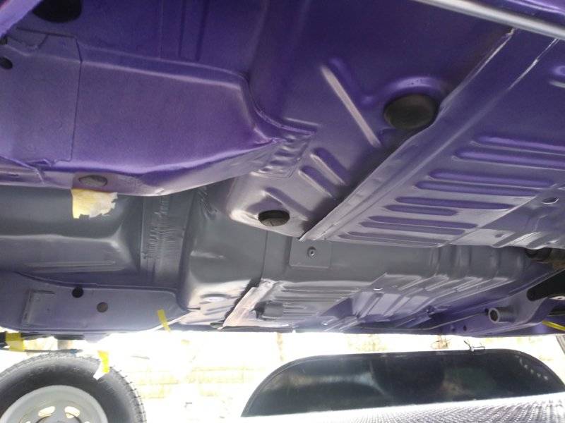

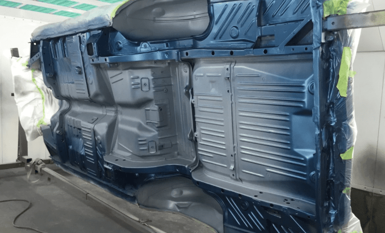

Yes the K member was a satin black and no overspray for exactly like you said it went in with the power train later. Sealer was applied before paining. I apply the sealer AFTER the epoxy primer on restorations. I just look more "finished" and you getting your monies worth buy painting the bottom.. It may help a little with future corrosion protection.
Lots of restorers are trying to match the dip primer like OE by using urethane paint color matched to the original primer...
Wow, guys, those look really cool. Pretty sure I shall attempt something along those lines. The thought of a glossy belly was disturbing....but, prolly would not last long on a semi daily driver. No wonder so many of these cars got rotten bottoms....they just was not set up for the super long haul....50 plus years......
