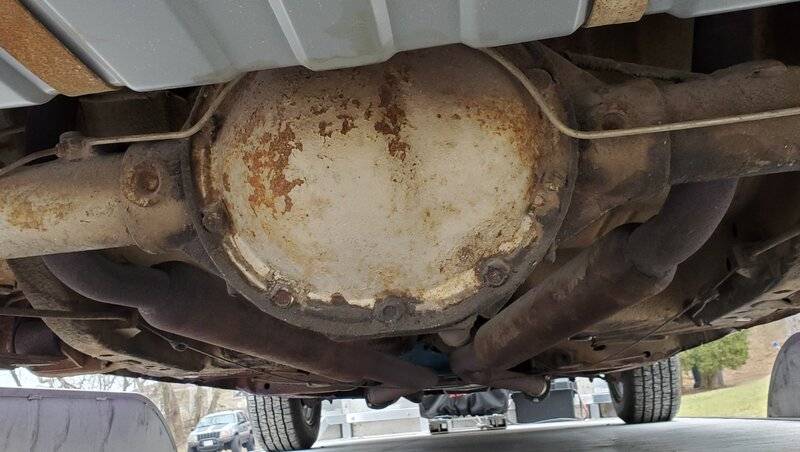

Shouldn't there be a tag or something hanging from the pumpkin?
I assume this is a 8 1/4? Weren't these still pretty fairly stout in 1972?
That is an 8 1/4" axle.
The tags they put on them usually only had gear ratio numbers. THey often get lost when the covers get pulled to drain the oil.
They are great axles for light cars with LA and Magnum V8s. They can live behind a heavier car or one with up to 400 HP but their weak link is the bevel/spider gears in an open differential. Extended one wheel burnouts will drastically shorten its lifespan.
Well that's a let down. Kind of puny for a heavy car such as these with a 400.
Then again, I guess it's latest 50 years, so it can't be too bad.
Is it going to be recommended that I get a stronger axel or can I get a stronger bevel/spider and just add a sure grip?
A good differential will help a lot. The 400 was rated at something like 250 HP in 1972 so the axle was not really going to reach it's breaking point.
I agree with the dog. Behind a automatic and adding a sure grip you will be fine.

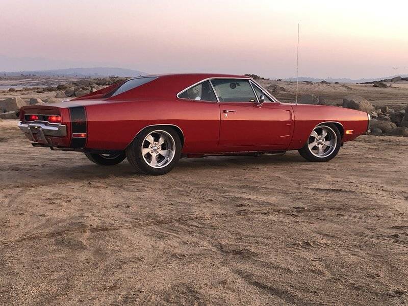

A 72 what ? B body ? If you are lucky the performance factory ratio was 3.21.
Yes. 72 Satellite. And in not real lucky, lol.

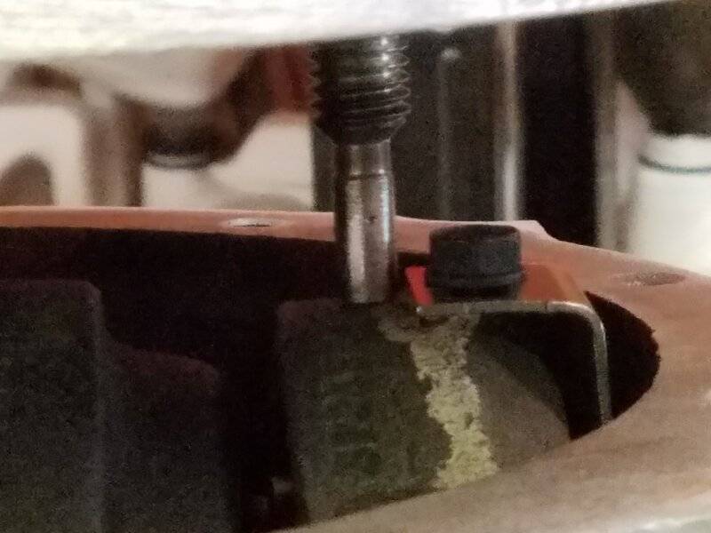

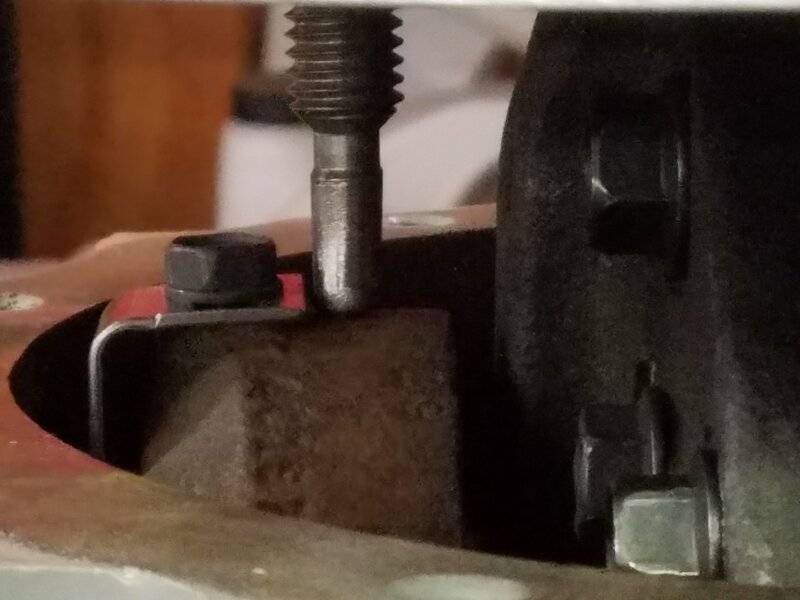

I'm rollin' the dice on a 8.25. It was free so
I figured I'd try to beef it up by adding a girdle
to bolster the bearing caps. The engine I'm
running doesn't quite make 500 so I'm hoping
it will last awhile. The other weak spot with
these is the c clips that hold the axles in the
housing. There's a kit available to eliminate these,
or you can install disc brakes as they'll keep
the axle from vacating it's home.
