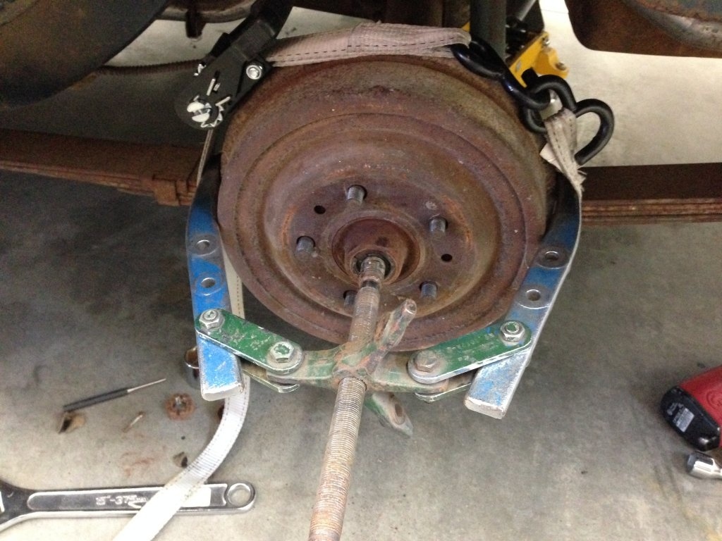

If it's a '62 diff you're working on, it can be a pain. I used a pulley puller with extensions rigged onto it. Some heat and a few taps and the hubs popped right off. Then I had to press the drums off the hubs. Supposedly there is a tool for this procedure, but I made do with what I had.

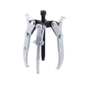

would this work
That is what I used with extra lengths added in to make it wide enough. Then I wrapped a ratchet strap around everything to hold it together. Kind of a pain but it worked!

LOL, actually the strap merely held it from falling off, not for pressure related tension. It came off very easily. A little heat from a small propane torch and a couple taps with a hammer. I was very surprised after hearing all the hype over how hard they are to remove.
gd, you had an easy one!
You could bend the center of the drum by grabbing it on the outside.
If that's all you have, it's worth a try but use common sense and caution.
