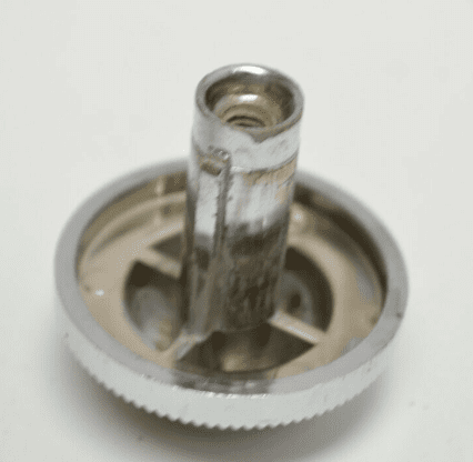

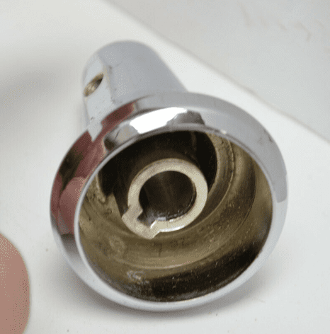

As far as I know ALL console shifter buttons are keyed to the knob.
Regardless if chrome or black button.
same goes for chrome or woodgrain knobs
Thus requires to loosen the allen set screw and unscrew the knob and button off as one assy

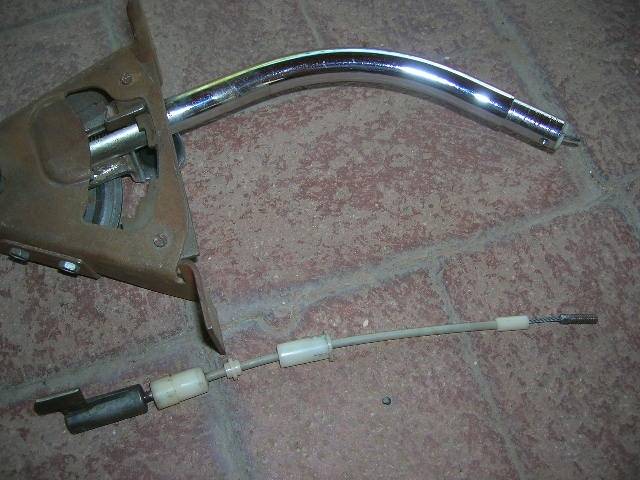

And once opened up there is a shaft thats I believe 8-32 threads , to some it may appear to be a cable, but its not
It's a cable with a fused on threaded end.
Sometimes the cable frays right below that.
What cable? Ya there is a spring below the button, that's why there is a set screw in the knob.

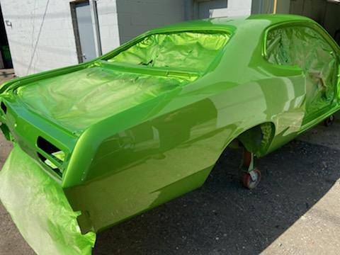

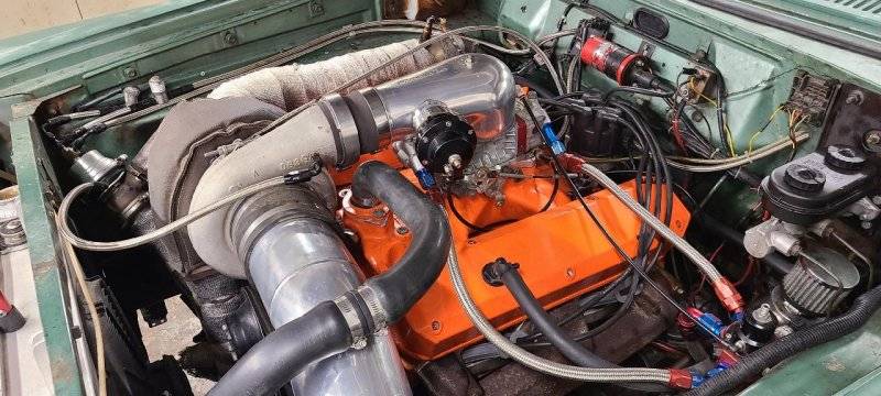

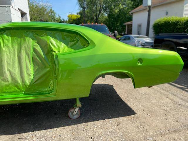

70 Duster. A good friend of my son who has always called my wife and I Mom and Dad. He always wanted to do a hot rod. Finaly got up some cash. We looked for a year for a decent Duster. Bought this one in pieces. Only 2 small patches in the body. Tons of extra parts. Came with all the 340 stuff except heads for $6k. Sold the factory disc, 8 3/4, ralley wheels, fresh 340 short block, 340 exh manifolds. Its getting the turbo motor from my sons 62 Plymouth. Pure street car. No cage.
Doug
