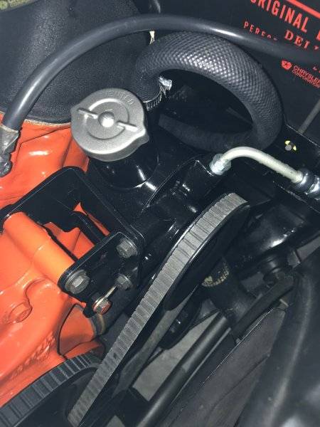

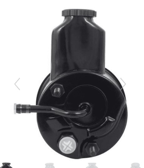

I just added PS to my 66 Hemi and everyone said go with a small TRW pump with 5/8” size return. You also have to use a 66 or earlier box with a 5/8” return.

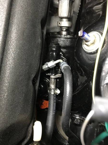

I feel like I’ve accomplished a baptism of fire accomplishing this change over on an early Hemi so if you are doing something similar and need a list of materials let me know.
Pictures of my installation. High pressure hose does not match original but original-style replacements are not available except maybe used.
