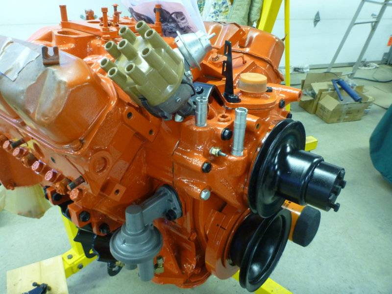

OK, I think I found it, its a tab with a hole. Is that 0? The are no number on the harmonic balancer, how are you suppose to time it?
One belt in the way.....?? There's a single line on the balancer, scale is on the timing cover tab. Hole is Zero..
I found it but there is no marks on the harmonic balancer?
Look at the picture I added... there is one cut line on the balancer.
