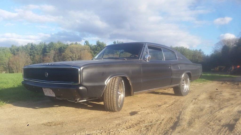

Finaly hit the open road after hundreds of hours building this car. Put about 50 miles on a test drive with zero issues and put it away for the night all smiles.
Hopped back in for a quick blast at lunch and promptly sized the rear end in the middle of the road.
Lesson learned....don't forget to check the rear end
Mine was bone dry.

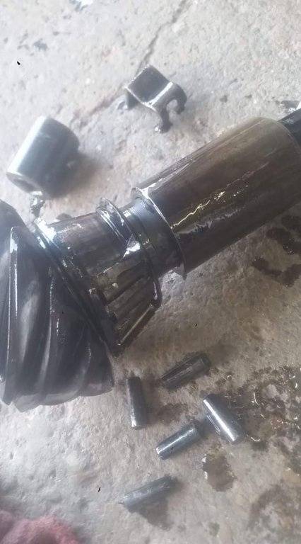

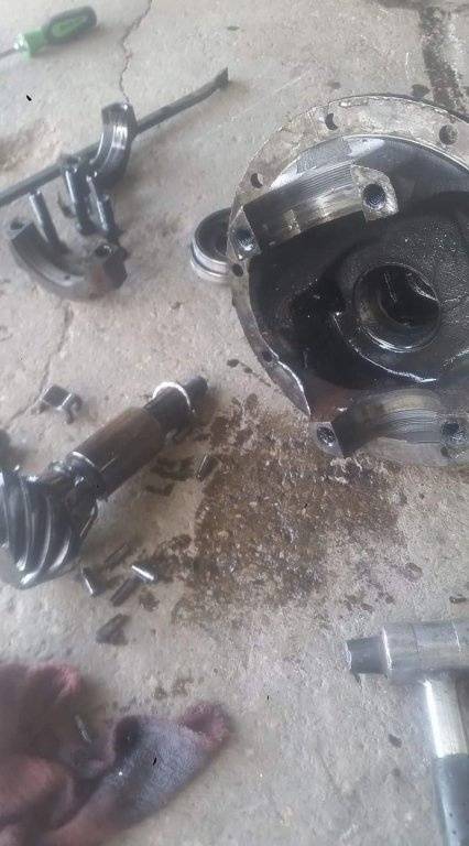

Seized the pinion bearing. Looks like I can get away with replacing that and the front seal..

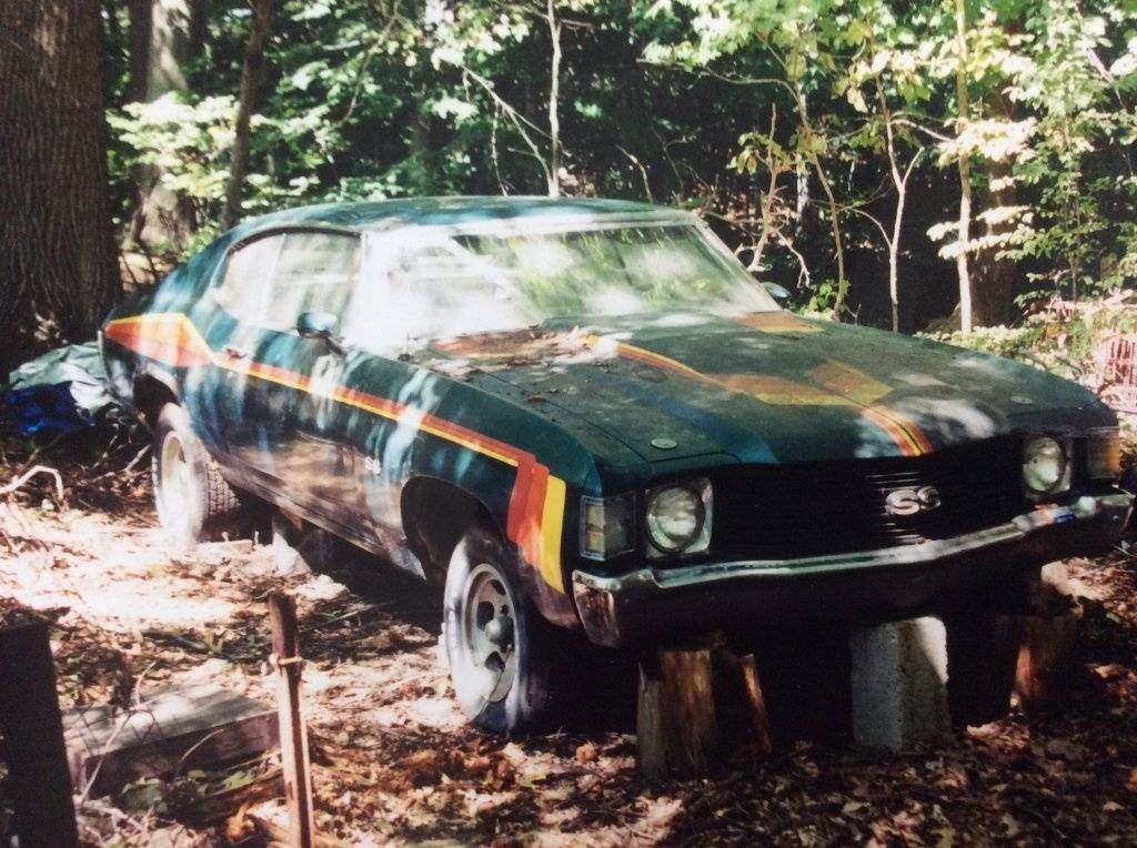

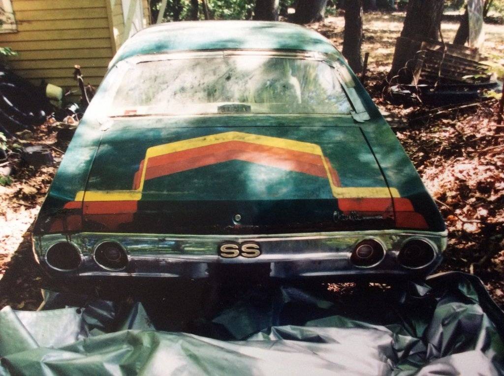

I had a 1972 Chevelle SS with a 4 speed once. When I PCSed to Korea, I parked it in my father-in-law's garage for safe keeping. After I returned back to CONUS, I took the car to a tire store and had new radials installed all the way around before I drove it from Tennessee to Washington DC. While it was up on the lift, I asked the mechanic to check the oil level in the transmission. He did and said it was right up there. Just as I pulled into the D.C. area, BANG! Broke the common gear and mating gear. No oil in the trans at all! I asked my father-in-law if anything happened to the car while it sat in the garage and he said, "oh yeah, I tried to move it around for you but I couldn't get it into reverse. So I hired a guy to come over and fix it for you. He took out the trans and saw that it was OK, but the shifter had a funky lock-out feature so he just reinstalled it." They never refilled the trans with oil!!! So I got screwed by him and the tire store mechanic. FYI, I asked my father-in-law to ensure no one even touched the car while I was away. FAIL!
Lessons:
1. Never touch the inside of the trans case with your finger when checking oil levels. You may get a false "read" on the actual level.
2. An oiless manual transmission will run exactly from mid-Tennessee to central D.C.!

All fixed. Roasted the pinion bearing.
Replaced both pinion bearings and topped off with oil. Back on the road again.
