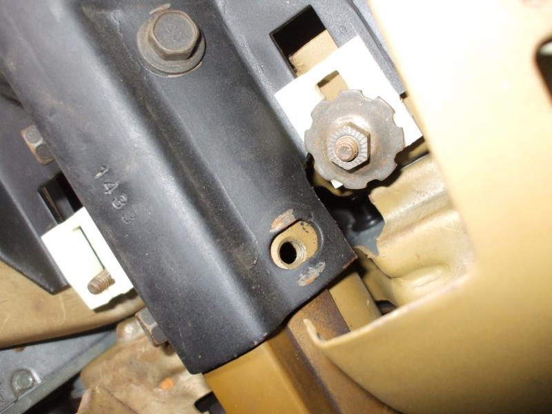

Ok I will go ahead and take another look. I did undo the screws beneath the cluster next to the steering column. How do I drop the column??? I'm a little confused by that. Pics would help.
Here is a pic from below. Take out the 3 fasteners which pass through the nylon slides. The mounting bracket can stay attached to the column 007.jpg
Again though, if all you are doing is installing a radio and replacing the cable, you dont have to fool with removing or even loosening the panel. Removing is a PITA. Just uncouple the cable from the back of the speedo by contorting yourself and carefully reaching a hand up there, with a well aimed light so you can see it, and disconnect it.
