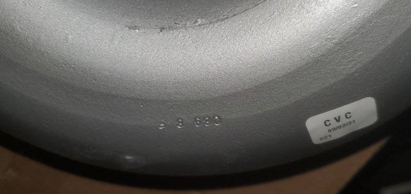

Ok, so I bought this transmission and I looked over the torque converter and there is a sticker that says "CVC" with a date of manufacture and "C21".
I looked it up online and "CVC" is a company that rebuilds torque converters. And "C21" seems to be a stock converter (not a stall converter as sold to me, however i don't thing he was 100 positive himself) and for a steel crankshaft.
I have a 1972 Satellite (block says 1973) 400 which is cast iron external balance.
What is the difference of the steel crankshaft converter vs the cast converter? Just the weights?
So much to learn. Ugh!

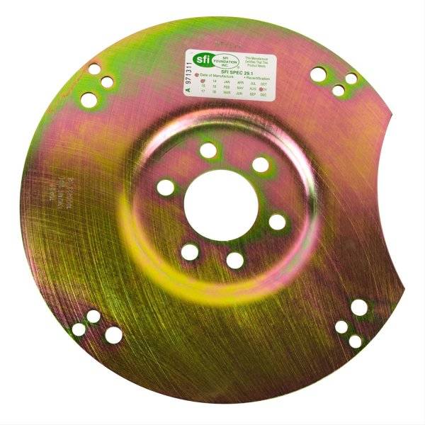

I am pretty sure you can buy an aftermarket unbalanced drive plate to adapt this to cast crank. Check places that sell modified converters or A&A Transmissions near Indy.
