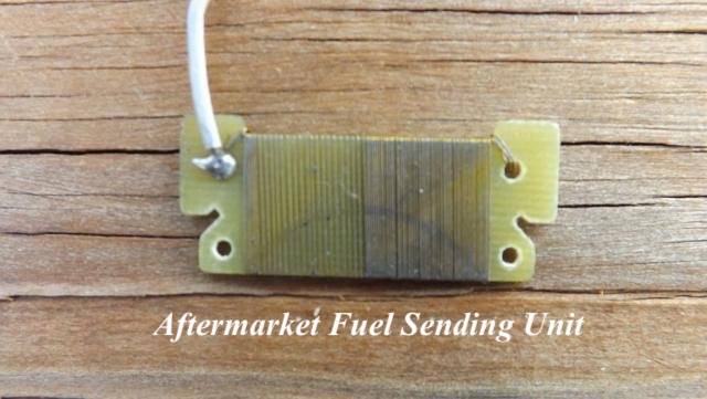

If the fuel gauge was linear it is easy to calculate but it's not.
That's what I said is correctly calculated assuming the gauge is linear. Correct me if I'm wrong but isn't the gauge non-linear?Look up the capacity spec of whatever type of vehicle you have in mind and divide by 4.

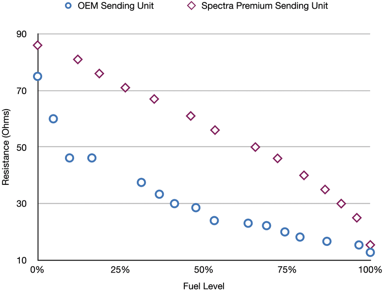

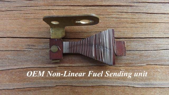

I do not believe the sending unit rheostat is wired to accurately reflect the shape and volume of the tank at all levels. If it's a 16 gal tank, the last 5 gals might show as a quarter.That's what I said is correct assuming the gauge is linear. Correct me if I'm wrong but isn't the gauge non-linear. ?
Thanks for that, post #3 and 16 are the good take aways. Looks like they did try tailoring the winds to the changes in in volume/ height.

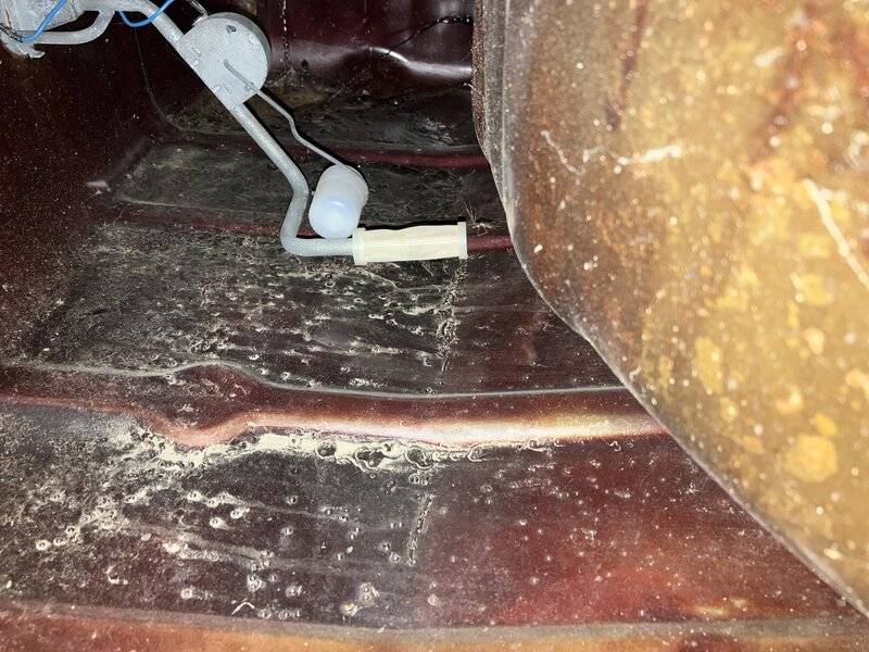

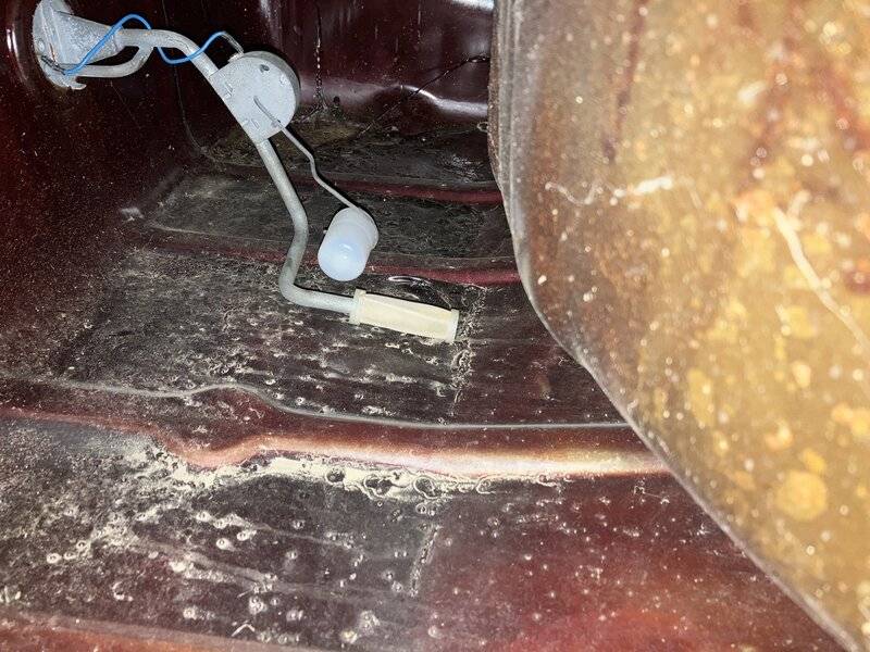

Bear in mind also that the float is in the deepest part of that shape of a tank. So 1/4 (which = approx 4.5 gallons) might show as a lot less than a quarter of a tank.
