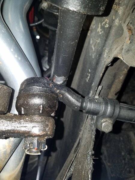

Reading the posts, I posted a thread about my Firm-Feel II install on my '63 Plymouth. What's happened is the left end rod has rubbed against the torsion bar (photo) shearing off the grease fitting and more (how I discovered the ill) and the cross link playing violin on the left TTI header (rebuilt poly). No demons detected on right side. My notes are somewhere I can't find; but recall the alignment was set pretty off OEM to gain a nice wander-less steer, have 15" radials and SSBC front disks. I've received several interesting posts on possible fixes; but I wonder if the alignment may have caused or contributed to this? Here I'm trying to recollect my notes that indicated the extent of modified alignment couldn't or shouldn't be done without some OEM parts changeout? The front is t-bar lowered around 1.75" over stock. The brake conversion didn't call for any parts change out...all bolt on. It's been some 2,000 miles on the car since all this was done. Motor mounts were replaced with the build and appear fine. I'm taking it to a shop next week (weather permitting around here) to get it back up on a lift to try to look further at what's what. Anyway, wondering about this...in case you experts have thoughts. Thanks.

Ron H, Have them look at the steering box mounting. It may require shimming.
Ever have the frame rail looked at ? It may be that the driver side may be higher causing the K frame to be off.
Even so if all is correct you may have to shim the K frame to frame rail to correct your problem.
As far as the header it may be a tube that was off in the jig.Even though you have TTI's (that's all I install) and new engine mounts you may have to shim that mount.Worst case is to tweak that tube a bit.I had to on one tube that was rubbing the T bar on the driver side of my 65. Just shootin' in the dark with thoughts.
Thanks much - A shop I've worked with is going to get the car on his lift so we can look closer at this and he mentioned what you have said here about possible need for shimming - I've sent 3 requests to FF asking for the install instructions and crickets. I don't have them and would like to review so I understand how this is to be installed in case something is amiss. Given the modified alignment to obtain the wander-less steering, I had wondered about any changes necessary beyond new bushings, or could be my linkage is worn where needs more than bushings. Hopefully shop can take a look next week and if roads are dry here take it over there. This is normally sleeping time for the car around here...lol.
