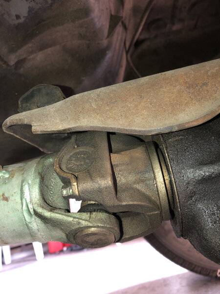

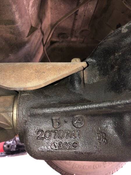

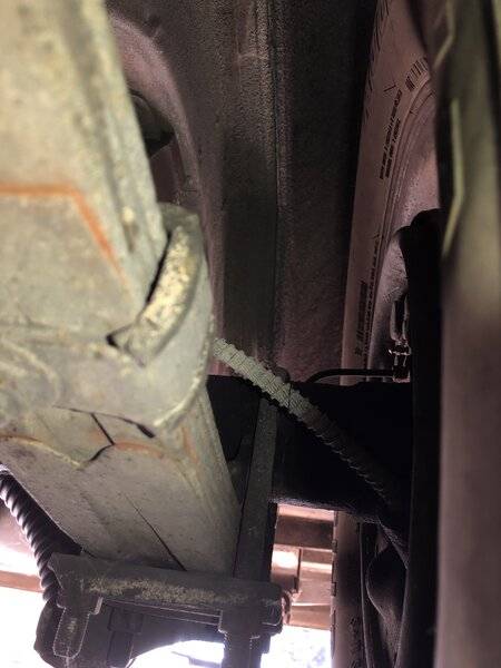

This car continues to amaze me, took more photos while I was under the car. I wasn’t sure what differential I had but went ahead and picked up a small yoke 742 with 3.23 sure grip….. good choice!! Plenty of room for larger tires too.
That 742 you picked up will be a great upgrade. If you got 6 quarts out, your transmission pan is slightly bigger than stock.

A 742 limited slip is a good piece. I prefer the larger U joint though.
it’s just for street use so it should be ok.
