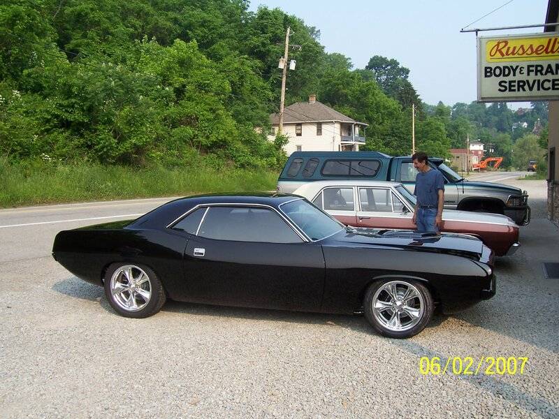

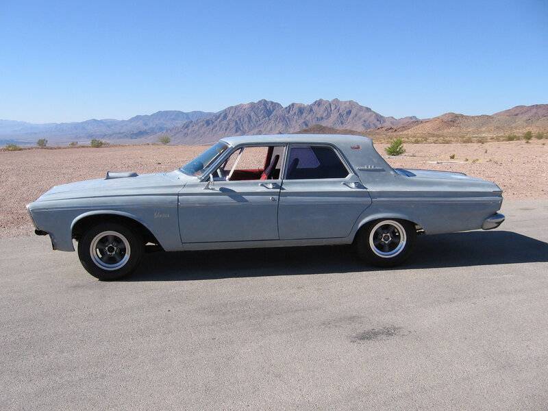

For a 67 Coronet and my 63 Belvedere we went with 100 lbs over stock with a 2'' drop.
Always been pleased with that combo.Photo of my 63 (with a 30'' tall tire)and a 'Cuda we did( 27 1/2'' tire)
All had a nice ride never stiff. Just a thought.We ran basic Monroe shocks. Tried KYB's on several cars and the ride was harsh.Careful on the shocks you choose.
The 63 with a 26'' rear tire was too small looking.
