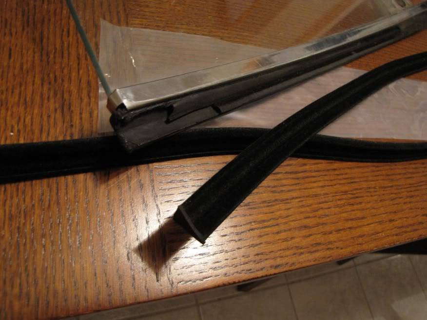

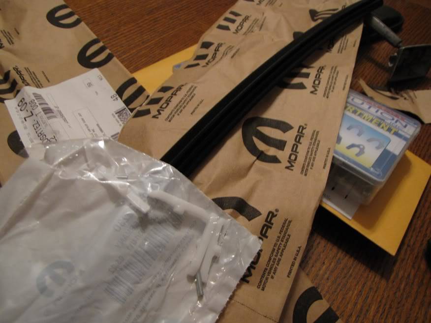

Couple pics..........
Hope it helps......Good luck

I actually already have both the seals for those windows so destroying the old ones won't be a problem. I would just leave the stainless trim on the window but the rubber that holds the window to the stainless is cracked and missing in some spots. My plan is to remove the stainless, polish it up, and using a bike innertube replace the rubber that holds the window to the trim. As far as Cordellj's question regarding the plastic slides I think he is talking about the other side of the trim that goes in the vent window channel. Those plastic slides actually break apart and are two different pieces held together by a little metal pin. You should have gotten these new plastic slides with the new weatherstripping.

I think you may be right Eagleone. Cordellj may be referencing the front window felt guides....Felt covered plastic, with a two piece plastic clip at the bottom/top, held together with a push pin, cut to fit. I don't think those can be changed in the car (would be really tough being they're a bit fragile/flimsy as well as real confined area), but outside of the car with the window removed is pretty easy. I know R/T specialties and Roseville Moparts sell them. That's where I bought mine. Pricey little suckers......
