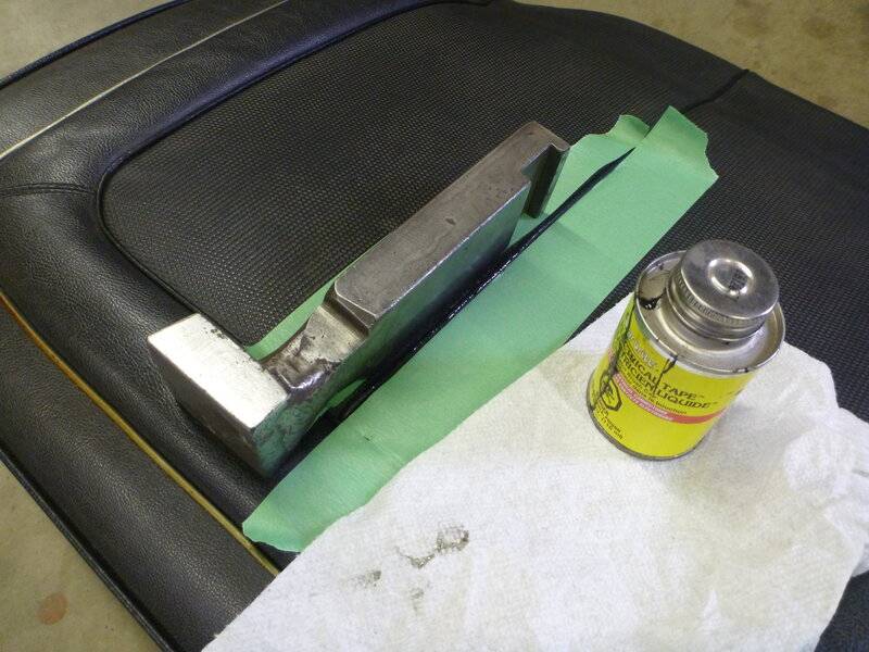

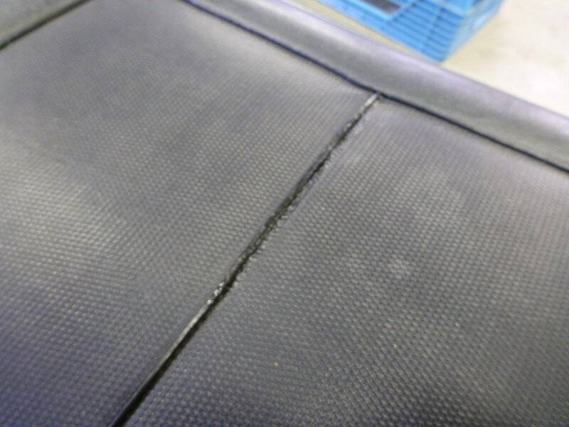

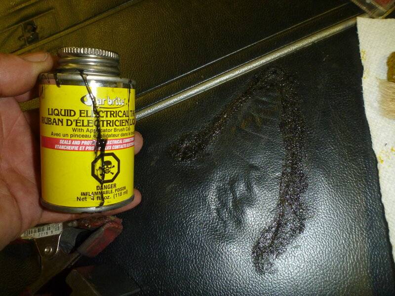

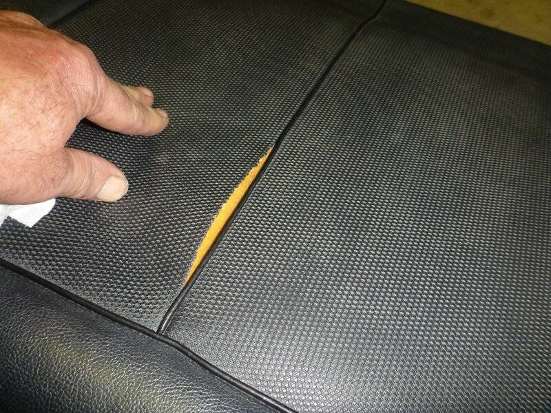

Yep... you saw my "fix' for that? :) Still holding after all the Bridesmaids where in the back and a trip to 'Dega and back.

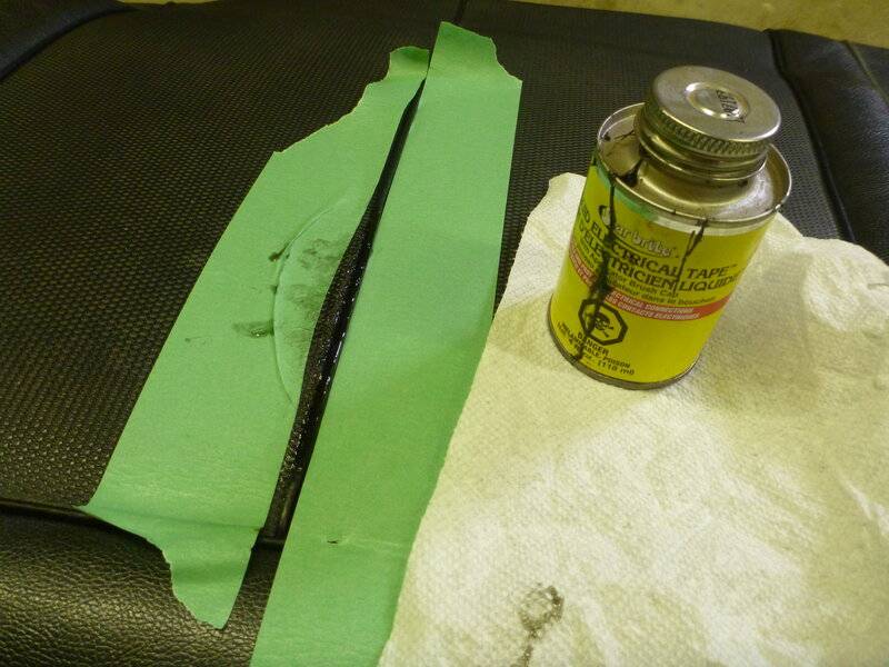

Pretty neat trick! How did you keep the sections 'together' so they'd mate or not separate? Or was the split mating enough after no pressure on the seat if I'm saying this right?

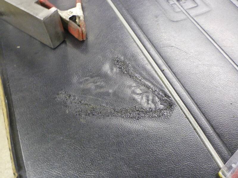

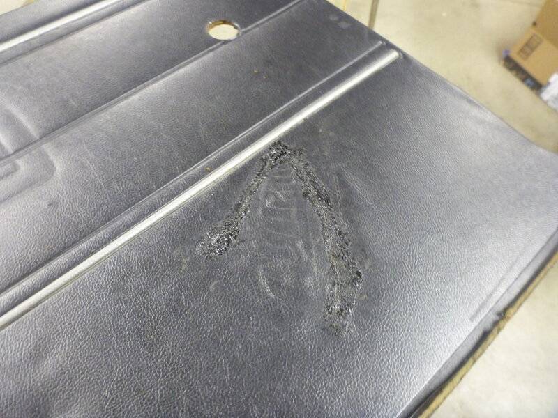

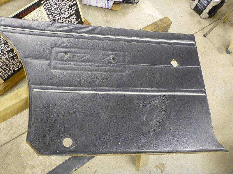

The 4 or 5 lb bucking bar is holding the seam nicely together while the liquid vinyl cures. Fixed my torn door card as well, from someone being overzealous to get the rear seat in or out in years past. Not perfect, but doesn't stand out anymore. You can get liquid tape in various colours. Black, White, Red for sure.
