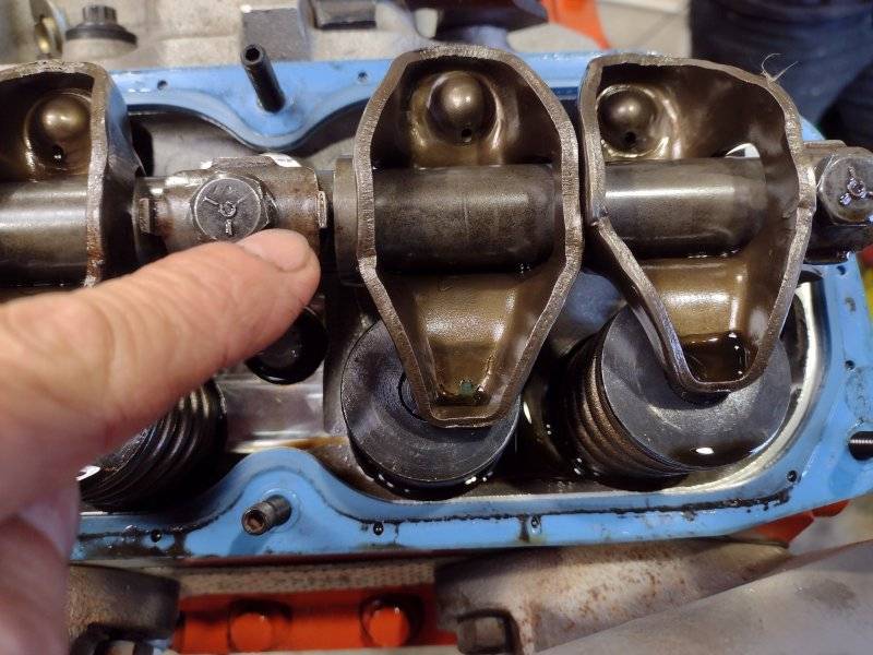

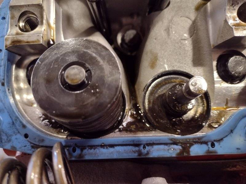

Yesterday a young lady brings me a hurt 440 out of her expensive 70 resto mod Charger that she recently purchased. The engine has under 400 miles and suffered some major damage because whoever built it missed the mark on the details. One clearly missed detail is a rocker arm spacer on the other bank was in the wrong position.
Why do people run those crappy stock rocker arms and 5/16" push rods in anything but a stock cammed engine!?! Dual springs with high open pressures have no business under those rockers arms. Making rocker arm skewers with push rods should be a clue that those rockers are not up for the job when high spring pressures are used.

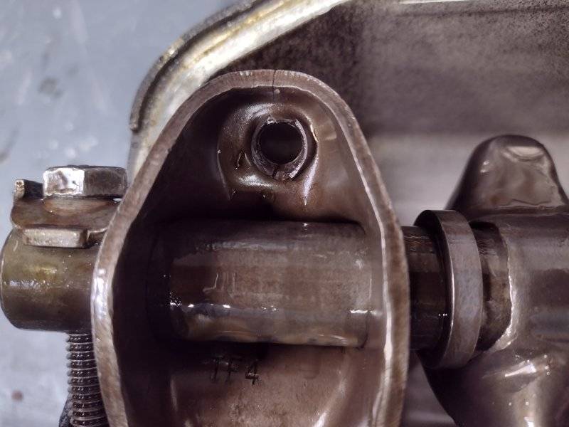

Also note a major factor in this failure was the retainer hitting the rocker. Hard to see here but the edges of the retainers where contact was made is present on most of them. She thinks the failure was her fault by taking it to 6000 RPM but it's not. A valve train that is substandard will become a secondary spring and tend to flex in unpredictable ways as RPM increases. Really bad things can happen at 6000 RPM and one must design accordingly.

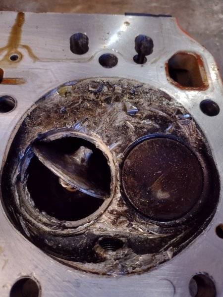

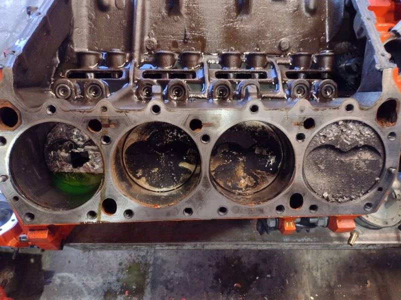

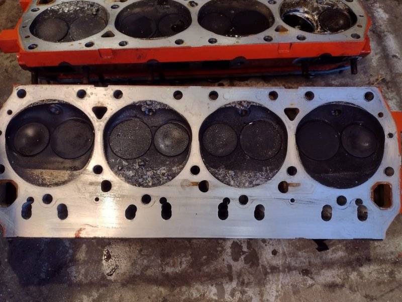

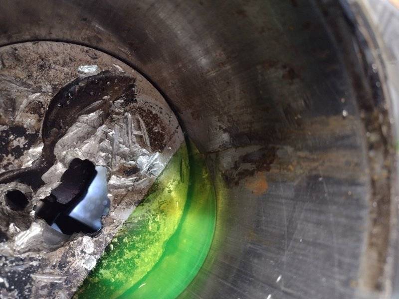

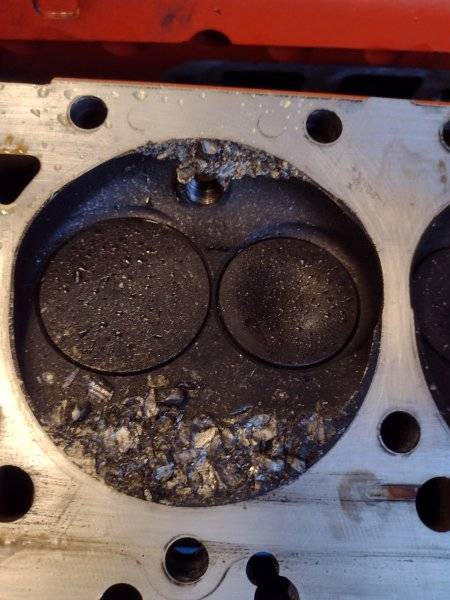

After pulling the heads the news only got worse. Crack in #8 cylinder, the intake valve seat from #8 found its way in three other cylinders. A small hole in #3 piston. Initially I thought the failure was caused by the high RPM and the retainer hitting the inside of the rocker, possibly dislodging the keeper. While that is not impossible, the failure may have originated by the intake seat falling out. Anyone have any similar experience with 440 Source heads? Seats falling out that is. I have no idea what cam is in it but it has dual springs and it's a hydraulic flat tappet.

I wonder if it was over heated or run low on water. That is the likely the most common way for a seat to fall out and destroy everything. I had not heard of Stealths dropping seats in years. When they were first introduced I had heard of it. That was years ago. Are they old stealths?
Overheated will drop a seat, but with that damage, who knows what happened first, the chicken or the egg. Rocker spacer on the outside seems to be turned 90°, so last 2 rockers were way off on space. The retainer striking the rocker was unacceptable. It all needs to be done correctly. Nothing wrong with 5 1/16" push rods, I haven't hurt mine yet, anything can get hurt. Ball is in your park, sounds like she can afford play, so do it right this time, so that hopefully it doesn't break next time.
Can't know for sure if it was over heated before she got it but according to her there was no indication of it. Yes, running too hot can cause the seats to fall out. But still, a properly made head should hold up to normal heat cycles and the occasional over heating. I don't know how old or new the heads are. The chambers look like Eddy heads.

Sleeve is the plan for the block. Heads are scrap. Maybe go with iron or Eddy, which do not seem to have seat failures that I know of. I'm a bit leery on Source heads from what others have reported over the years. Many say they are fine so really can't say.

Holy crap that looks bad.

Amazing how the trash found its way into 4 cylinders on either side of the engine. Through the intake?
