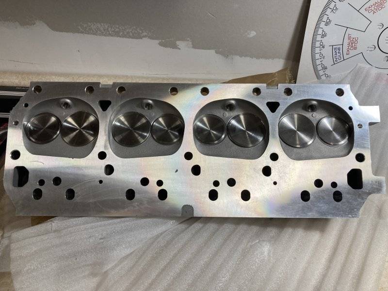

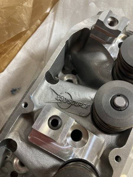

Well that's not comforting. Wonder if there is an issue with Stealth heads and the intake seat press fit? They use A356, which is the preferred material.
Wouldn't be surprised. Who knows who put the seat in with who's equipment? Ever heard of the chrysler 3.6? The old focus split port motors? 5.7Hemis? I was scared putting seats in old cast iron heads.
One possible chain of events, over revved, valve struck a piston, valve head broke off, piston jammed against valve head and cracked the cylinder, hydrauliced the cylinder, valve head hammering the seat may have caused it to dislodge. Been there, done that, except for the valve seat part, mine had iron heads. Is the rod badly bent? Mine looked like an S.
If she wants to take it to 7000 rpm why not build her an engine that will do that? What’s wrong with trick flow 270s and Harlan Sharp rockers?
Sleeve is the plan for the block. Heads are scrap. Maybe go with iron or Eddy, which do not seem to have seat failures that I know of. I'm a bit leery on Source heads from what others have reported over the years. Many say they are fine so really can't say.
First I've heard of seats dropping out. They have had issues with the stock 7° locks in the past. I went 10° locks/keepers, cnc ported, stock valves, and spin in to 6k often.
