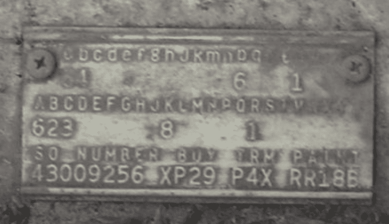

Umm….Does this reveal a build date? Have a title somewhere (and the window sticker, the 4 speed was a $187 option)
September 25th 1966Does this reveal a build date? Have a title somewhere (and the window sticker, the 4 speed was a $187 option)
Scheduled build date 4-30-1966Does this reveal a build date? Have a title somewhere (and the window sticker, the 4 speed was a $187 option)
This is a 1966 tag, by September 25, 1966 they were building 1967 vehicles.September 25th 1966

what date range of blocks would appear as original to this car? The original engine has two spun main bearings, broken pistons, and a slew of bent push rods. It ran when parked, but went knockity-knockity.Scheduled build date 4-30-1966
