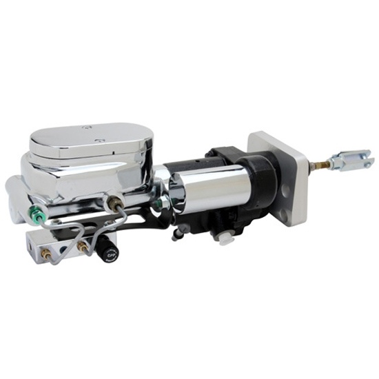

I've noticed a lot of people are starting to run the hydroboost type boosters in classic cars instead of the big traditional vacuum boosters.
They ain't cheap....but I think there are many different mfgs with offerings..
