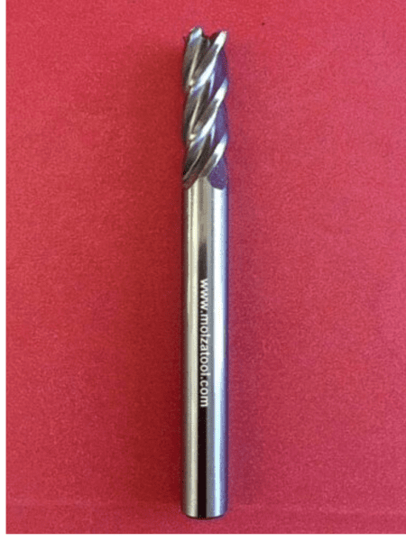

I personally like using a cheap Harbor Freight milling machine.. after the small hole has been drilled....
plunging a sharp end mill in the same hole position with a end mill will result in a clean precise cut.
also being able to be regulate the speeds........ especially with soft aluminum with a coolant..
a larger drill bit isn't designed for clean cuts with soft metals in the manor you described....
The result may end up ruining the work piece and the tool.
My 2 cents worth....
