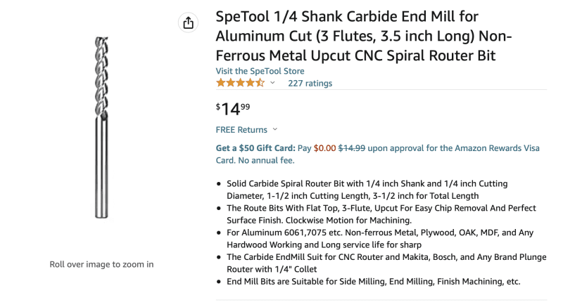

Thanks for the help. A ball end burr gets me what I needed. Now I want to enlarge an opening. It's 2 3/4 inches down inside of the casting. I was about to go pawn shop hopping to find a Router as the Internet says they will work fine on my aluminum. Would like to clean up the bottom too. Thinking this end mill in a router:
1/4" bit is just fine. Too big of a bit might present a problem because of the distance between the flutes or cutting edges.
