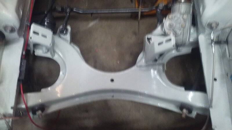

Ready to put my Max Wedge into the 63 Plymouth wagon. My concern is did the K member get changed to a later model. This was a trick used in the early years to move the engine back about three inches. Is there a measurement or something that shows if it's the correct one for a 63? If it's the wrong one I need to change it or my step headers won't fit. Thanks for any in put.
Looks correct. The motor mounts changed when they moved the engine back. Old one like yours needed the mount studs to go through those slots and get nutted on the back side. Newer ones had tabs On the mount with a bolt that goes front to back.
Thanks. I thought it was the correct one, but wanted to check with someone else.
