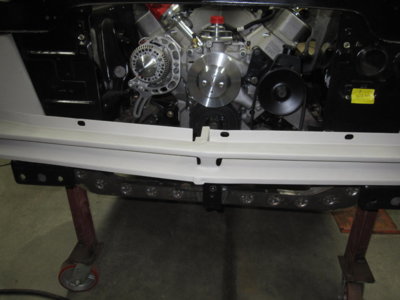

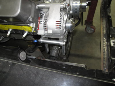

I thought I would post a couple shots of the Billet Connection brackets. I'll try to post more later. I really like the idea of the compressor and alternator each having their own drive belt. The compressor pivots on a billet piece that bolts thru the front cover, yet does not obstruct the timing tag. The only draw back to this system is having to use a "Ford" alternator.
Mike
