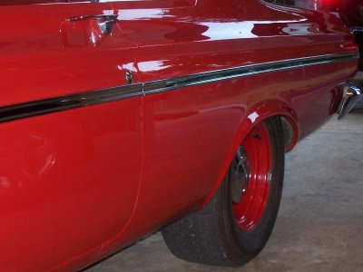

polish and wax
depending how bad the paint is. mine was bad so i used 3m rubbing compound it has more grit and used a buffer. 3m polishing compound has less bite, try that first. then i went over it with pure carnuba wax. when you use the buffer on that original paint keep the buffer moving and watch out for the edges so you dont burn thru the paint. heres a pic of my barn find. alot of work but looks better. hope this helps you out. good luck...USAROADRUNNER:sFl_america2:

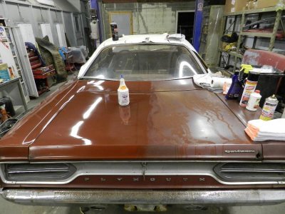

I use nothing but "dri wash waterless car wash".
it works for me.:icon_neutral:
because,
*no soap
*NO water
*no vac water out or "blow it out"
