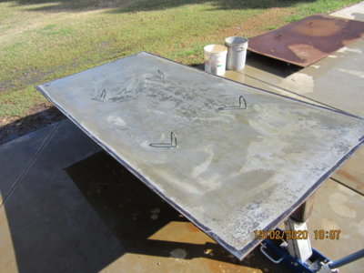

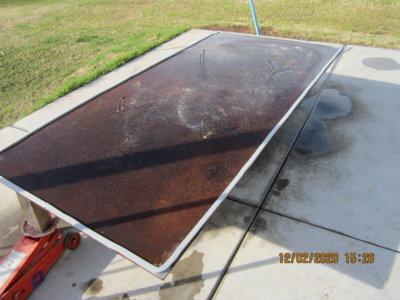

I bought a couple of rusty 4 X 8 steel plates to make a welding table. I was going to sandblast them, but it would take weeks and a lot of sand using my small harbor freight blaster. Plus its real messy. So I decided to try Vinegar. I went to the $1 store and bought 5 gallons of cleaning vinegar. I got the loose rust off with my 7-1/2" grinder with a wire wheel. I built a dam around the edge with weather stripping. I then filled up the plate with vinegar. Let it set for a few days. Every so often I would run a hand wire brush over the surface. Had to keep adding vinegar as some did evaporate. Then I cleaned it off with my pressure washer. Came out nice. I am surprised vinegar actually worked.

Easiest way to remove rust is to sell that damn ford right now.. Kidding light surface rust you can use vinegar and water solution. lol i grazed over your post.. My bad You are giving a how to, not a how do I? looks great
Yep. I've used it a lot on parts that have nooks & crannies that are hard to get to with sanders, or wire wheels.

I tried Lysol Toilet cleaner today on my other rusty sheet of steel. It didn't do anything. So i'm cleaning it with vinegar like I did the first one.
