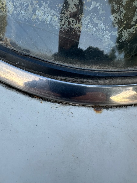

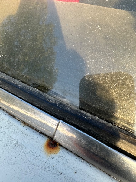

Hey All,
Addressing all the visible rust on my 1965 Satellite, I see some spots creeping out under the rear glass gasket.
Has anyone removed the rear glass and re-used the gasket? There’s nothing wrong with the glass or gasket, and it would be nice to reuse it.

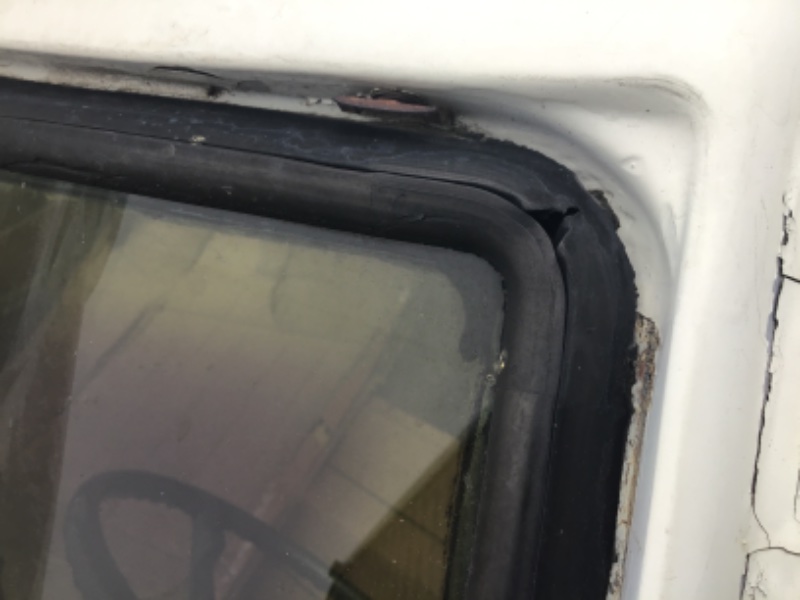

You are referencing the front window gasket. On my 65, the rear gasket did not have the locking feature- only the front gasket did. The rear window went in with the rope and sealant method.
To the OP, no matter how good you think the original gasket is, once you get it out, you will probably find it is not as good as you thought. It is set in its place as it has been for the last 60 years and is not as flexible as a new gasket. As difficult as it can be to get the rear window in, you’ll want as flexible a gasket as possible. I would spring for a new gasket.

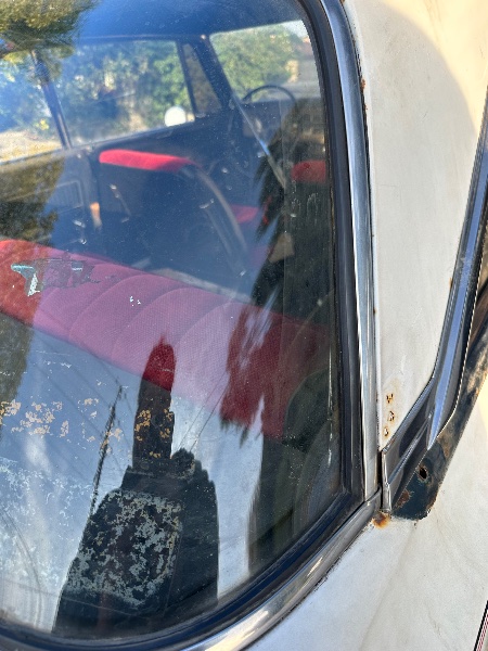

Thanks all! I was hoping to save the original gasket because I thought I read somewhere that the 65 and older reproduction gaskets and glass are TERRIBLE. my windshield is cracked and needs replacing too since I’m replacing the cowl. Got a new windshield and gasket for that, and I’m expecting to run into a bunch of issues if what I read is True. So since the rear glass and gasket is good, I was hoping to put it back how it is now. I wouldn’t be messing around with them if not for the rust spots.
My personal experience; the front went in much easier than the rear. I had new front glass and gasket - and old back glass and new gasket. Your mileage may vary.
