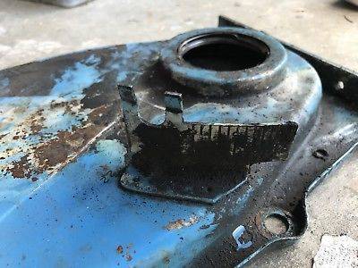

Do you have this tab on your timing chain cover?
Are you referring to the tab being missing on the cover? If so, you need to replace it so you know where you're at but using a vacuum gauge will tell you what your engine likes, if you advance to obtain the highest reading, you will be close. Tighten the hold down bolt and see if she starts easily there, if not then back it off a notch. I use a digital hand held tach too because you can see instant changes. Engines are different, one want's an initial of 14 btdc and another likes 18, this is where the vacuum gauge comes in. In all cases, disconnect the vacuum advance before setting initial. You still need to know for sure how much timing you are running though because as already mentioned, if you have more than 34-36 all in then you are flirting with disaster......detonation
On these mopars, there are no numbers on the balancer. There is a notch / line in the balancer. That’s the top dead center mark. You should have the timing tab on your timing cover... passenger side.. as kryslerkid posted.

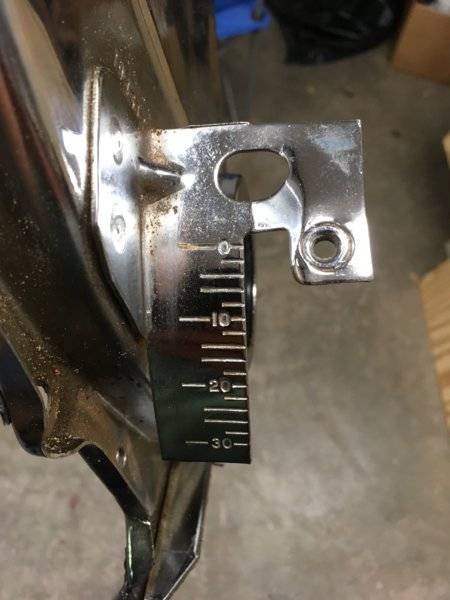

2) Clean the timing tab real good and mark the 0, +10 and -10 with white out. Your timing tab should have a line for 0* clearly labeled (some also have a hole on the zero line). There should be two or three lines in each direction, these are in 5° increments. Most timing tabs have the +10 in -10 clearly labeled.

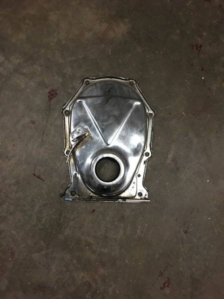

———— Edit:
Here’s a pic of an aftermarket timing cover I have - timing marks are a little different - I think these are the 70’s timing marks.. your 68 should just have -10 through +15 I think.
wish I had my old 383 damper, but “she gone”. I’d have shown you how it all works together...
But once you find the marks l, even I can do it.
