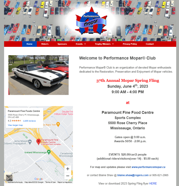

Will you be taking the GTX to the Spring Fling show this weekend (June 4th)
I'll be there.

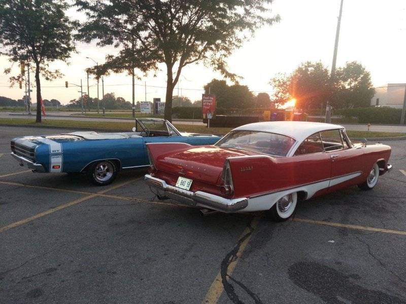

Unfortunately it will not be there.
Still need a dash pad (its coming) and get the engine mounted on the K-member to get it ready to mount from underneath.
See my build postings in the members projects section.
If my buddy gets his 58 sorted, I'll be driving it to the show.
The ragtop Dart will be there too.
Beautiful cars! I'm a little nervous taking the GTX, haven't put enough shake down miles on it yet. Will hopefully get the timing dialed in and everything running smoothly by Sunday.
