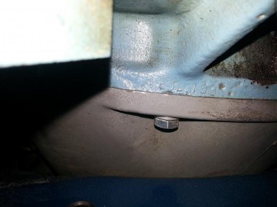

Found the engine s/n at this location by the oil pressure switch but nothing on the trans. do you think this would indicate that the trans is not numbers matching? Is it possible that the vin stamp on the trans is in another location? This engine serial# does match my vin. I going to take another look from underneath where Monaco66coupe suggested. Thanks for your help.
As I said that is a good vin#, take a wire brush on the main case of the transmission on the vertical surface below the kickdown and shifter shaft,driver side above the oil pan. The number will be there. at least you will know what the transmission came from.

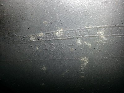

Found this series of numbers on the trans
trans.jpgnot sure what these numbers are. Any idea?? Appears to be 72 3410433-3
I checked a couple places for the stamp number you listed. Can't fin a transmission with that number from 1960-1981
Looking at your pic of numbers, paint between engine and tranny doesn't add up.. Something has been out of the car for sure.
As Monaco.. Said look for that number starting with PK..
