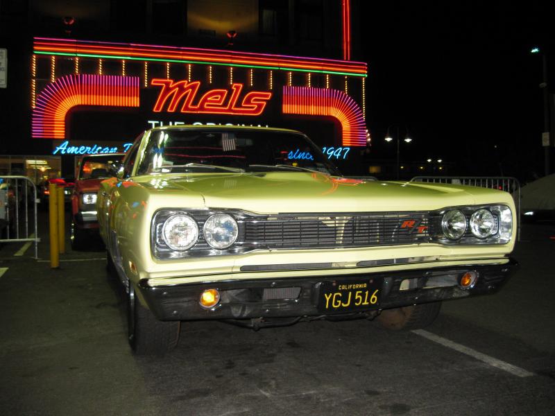

I enjoy driving my 44 year old muscle car. I drive a 1969 Coronet R/T with a stock 440. I've never had anyone try to get me to race on the street. They just give me a thumbs up and drive on.
If it ain't broke....drive it til it is. Then, if you're so inclined, spend all that money you saved up on a mild stroker.
