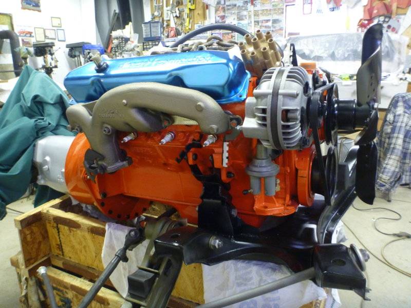

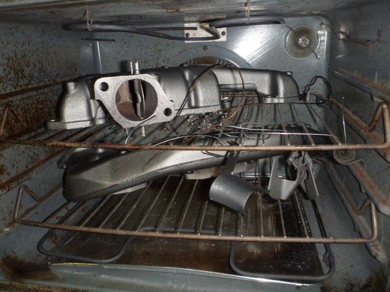

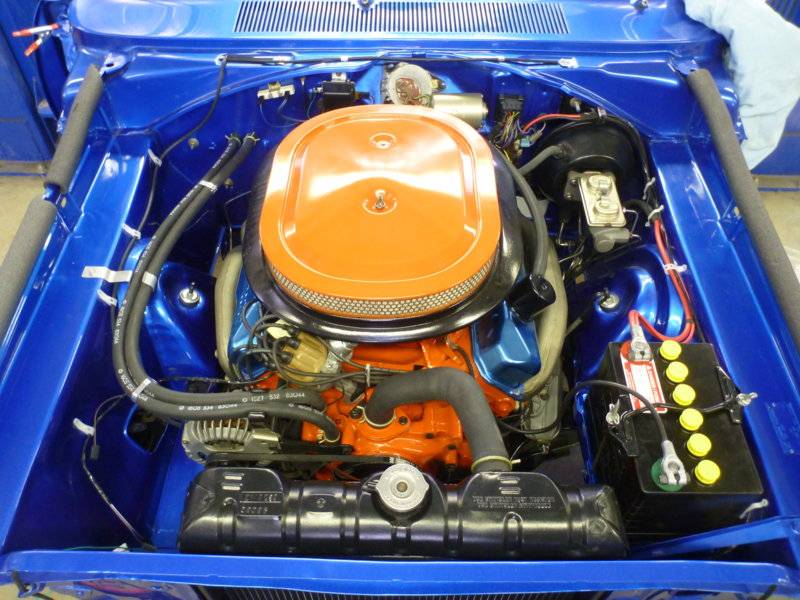

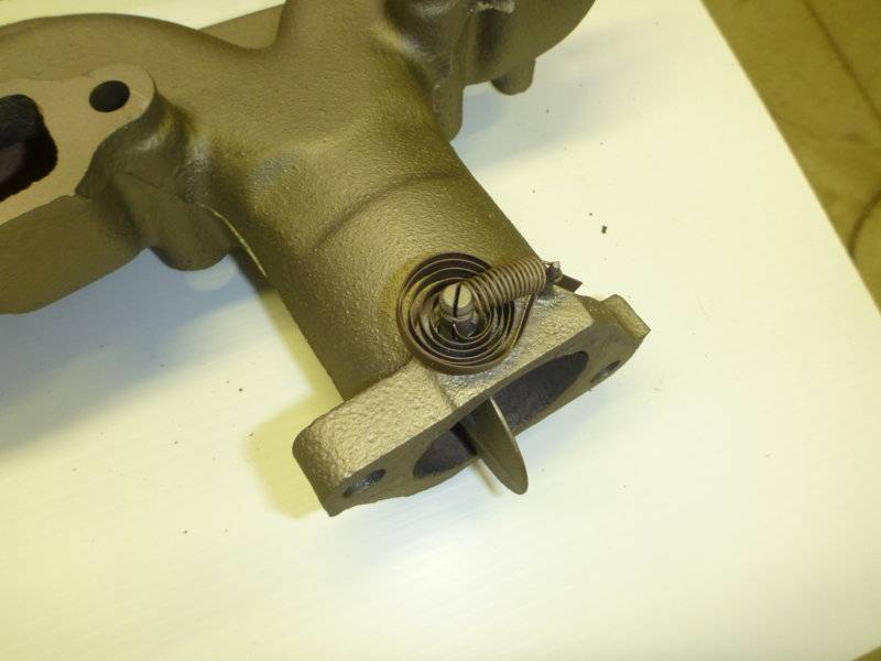

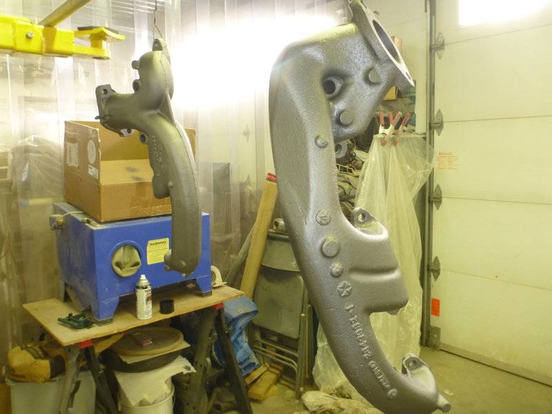

Blasted and painted mine with VHT "cast iron" colour high heat manifold paint and then followed the full baking process using an old oven. Not a lot of hard running at this point, but seems to be holding up well. I tack welded the heat riser wide open and restored the spring / counter weight for OE looks. I run a manual choke..

manifolds look great dadsbee ,Might have to do that. did it stink bad baking in the oven. I would have no choice but to do it in the house.
Wait 'till the wife goes out... bake them... walk around the house with a rag soaked in Turpentine... you'll be fine! :canada:
