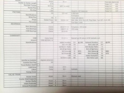

Similar Cam. Awesome Car-Show rolling waves. 480 torque and 415 RWHP per chassis dyno. image.jpg
Comp. CRB XE275HL-10.
