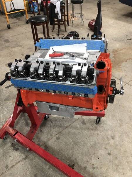

I decided to check clearance on the valve covers with each rocker. Hughes wins! I'm gonna run stock-looking valve covers and they teeter on the Harland Sharp rockers and sit flat with Hughes. I checked the fit with no gasket. The Harlands run into the baffle. If you're dead set on using Harland Sharp you could always grind off some of the rocker or cut a hole in the baffle. The gasket might give enough clearance as well. For me, I'll just run the Hughes rockers! Hughes also sent a bunch of shims and spacers with to get the set up right.
