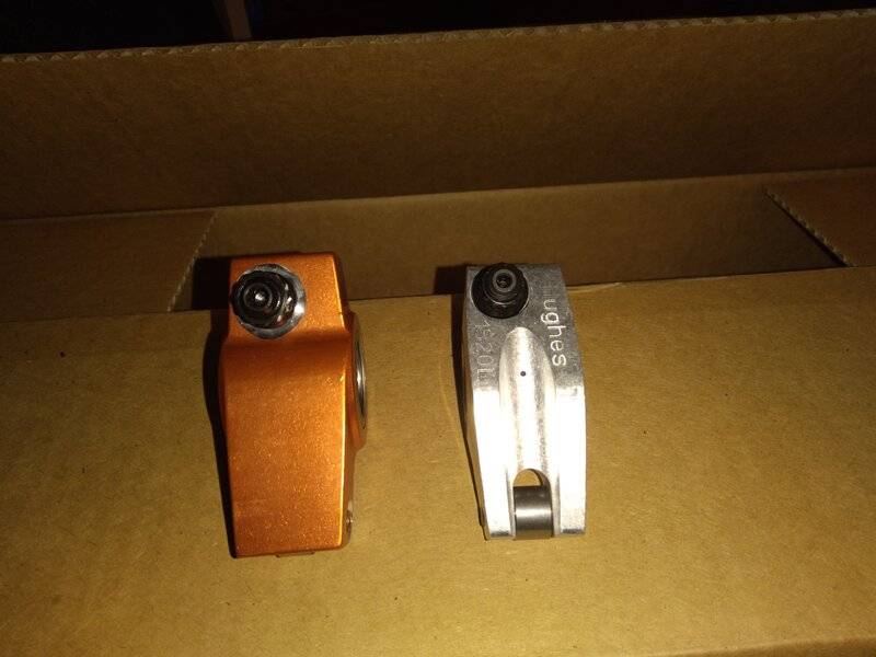

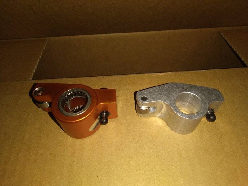

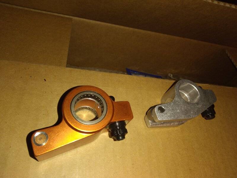

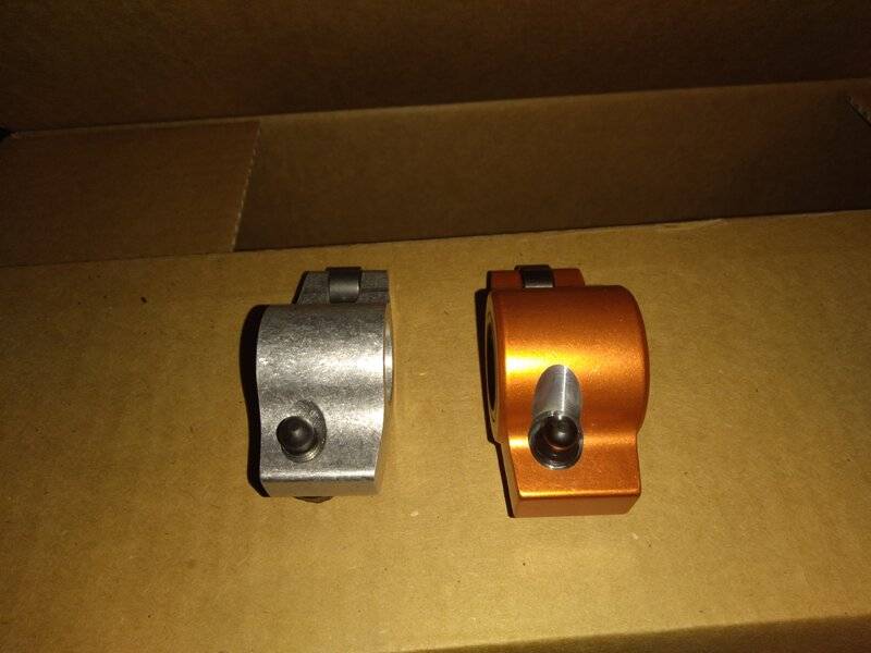

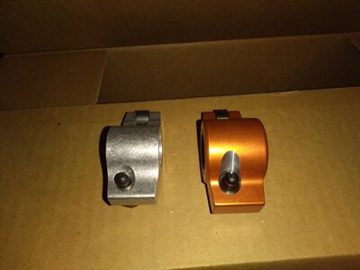

Comparing these rockers side by side, they are very different. The Huges ones ride directly on the shaft with an oil groove on the bottom. Oil holes on top for the roller and on the side for the pushrod. Very simple design. The Harlands have 48 rollers for the shaft and one oil hole for the pushrod. That's 768 things that could fail!!!

I see no similarities that would suggest Harland makes them for Hughes.
The HS rockers are much more robust. The rollers are hardly something you need worry about, there are million of these types of bearings in use in much worse environments. Personally I'm more worried that the Hughes rockers would gall on the shafts. What its going to boil down to is A) what is the user comfortable with and B) can he afford the cost of the HS's.
