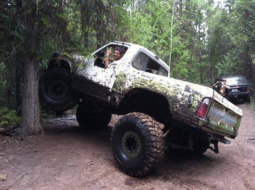

I would suggest the 3000 stall for that cam. Do not buy a TCI anything, I bought one once and it was total junk. My son has a Hughes in this truck behind a strong 440 and he's beaten it mercilessly for 6 or 7 years, highly recommended.
Funny that a lot of people do not recommend TCI and their converters are double the price of a Hughes converter.
Thats a good looking truck, btw.
To get a D100 or W100 truck here you are paying top dollar already nowdays.
