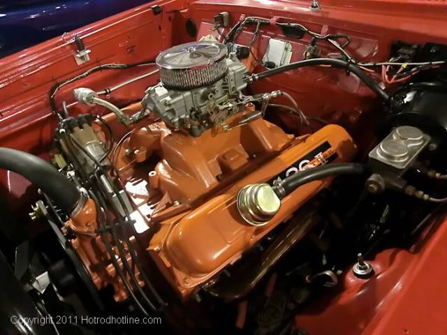

On my 63 the brakes are all stock as it has power drums brakes on all 4 corners. I went to the Master Cyl you see here as its for a 67-68 Sattilite. It bolted right on and fit perfect with no mods. Gotta have a dual Matser Cyl to race in my opinion. Ron

I think that's a drum/drum m/c.
